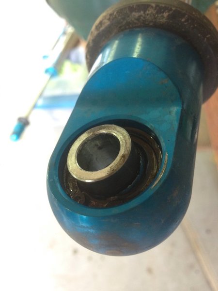

    Ideas to get the little spacer out?

    Penetrating catalyst and vice grips. Try not to bang up the road and too much.

    and about the missallignment spacers, i used vice grips, and on some i had to use penetrating oil and a flat head screw driver and a hammer and put the screwdriver in the hole and ran it around the lip with a hammer slightly.

    they are in there pretty snug lol dont want to F them up either. was gonna put my bypasses on while i had a little time. was gonna use the ones from the smoothies but either way id still have to get some cause one shock wouldnt have them. i tried to call the local desert rat and 4wheelparts and even went in to show them exactly what i need and they looked at me like i was stupid. shops in new mexico are douche bags anyway so i wasn't surprised lol
