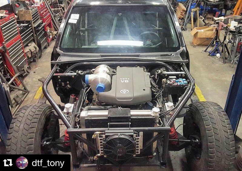

    just got a simple lift on her
    WAY BADASS!!!!!!

    1996 tacoma 4cyl, 5spd
    Those are funny lookin links.

    99 turbo 5 lug long travel
    Kinda stock
    I've seen the meme about it never getting finished,jk.
    It look beast.

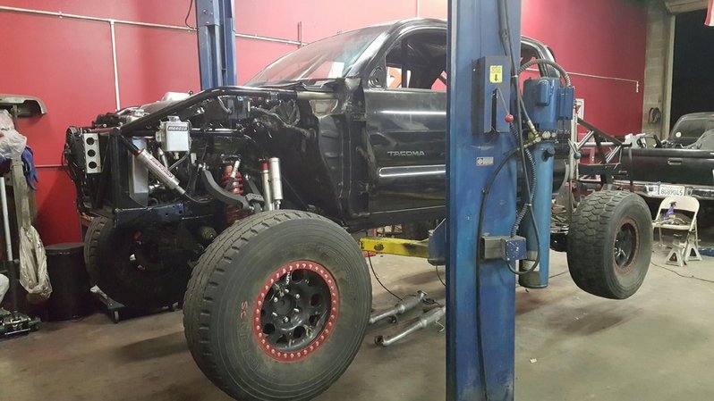

    ...too much shit to list.
    That's some fat lug centric wheel spacers.

    ICON / LSK
    temporary till new axles are drilled
  13. Oct 15, 2015 at 7:12 PM
    lembowski
    lembowski Well-Known Member
    Jul 29, 2009
    #20347
    6,882
    Rolando, CA
    Jeeper Creeper
    Think they are getting the Tundra axles plugged and redrilled. Those are just temp.

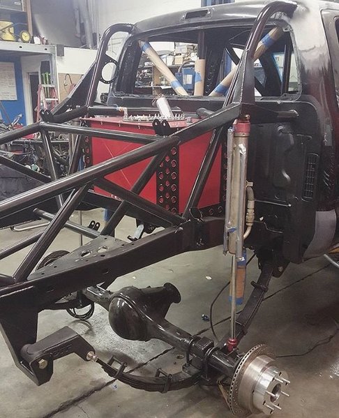

    Flagstaff
    Solo motorsports XLT LT, foxshox
    Trucks fuckin sick but why all that work for leafs?

    ICON / LSK
    so we can race it in class 2000/7100 if we choose to. personaly i dont wana link it, then ill have/want to fuck with the motor and be racing a class with people who have larger budgets devoted to racing. ill honestly admit i love the truck but dont want to be that deep in $ into it, its not worth it for me. rather use that extra cash to have some fun racing it or for other expenses when stuff breaks, belive it or not im on a budget lol
    but sure if i wanted to i could have dropped more cash to link it but it wasnt worth it for me, the only reason i considerd it was for resale value. i did everything with the truck i wanted, only thing im wanting to change is ditching thoes rear wheel spacers ASAP lol. and maybe the rear axle depending how the tundy 10.5 holds up, it was just a pretty affordable and easy swap so figured id try it out since the other guy from the shop with the tundy 9.5 has had no issues.

    The Trifecta of Taco's
    Truck is looking fantastic man. I doubt you'll have issues with the 10.5. Especially if you truss it.

    04 Prerunner
    We're biased obviously, but I'm a big fan of 7100. And I say that as a guy who worked hard to push SNORE to create Class 2000. Class 2000 is cool too but I personally don't like the motor rules as much as I do in Class 7100.
    The beauty of 7100 in my opinion is that the stock motor rule keeps the playing field level. This past weekend we got beat off the line both days by a single cab 4.0 Ranger. Our 3.4 with an auto just didn't have the juice to out drag him. BUT...it's close enough to be able to get us enough power to make up the difference in the rough allowing us to run our truck competitively in class.
    We would not be competitive in Class 2000 right now with our stock 3.4. Well, we could be, but we'd need other guys to have issues. In a straight up fight we aren't beating V-8 Rangers and single cabs with 5.3 Chevys in them unless they have problems.
    It costs a bit more to race 7100 in BITD, no doubt. But the rules are about as good as we could get them I think to keep it simple and fun. Either way, 2000 and 7100 are great opportunities for guys to get out of spectating and in to racing if they're so inclined.
    We're pretty content with our leaf springs!
