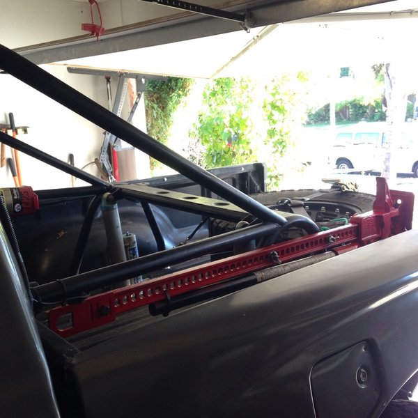

    image.jpg How would you guys mount the shocks for outside the frame rails? I can't think of a good...strong way...don't wanna build a new bed cave

    No need to rebuild it. You have plenty of room to plate and box in mounts on the outside of your hoop. Add a few tubes and some plate and you're in business.

    I'm really bad with making like boxed ate things lol...I was thinking about running hoops vertical off my hoops lol...but seems like to much stress in the tube....I really can't picture it

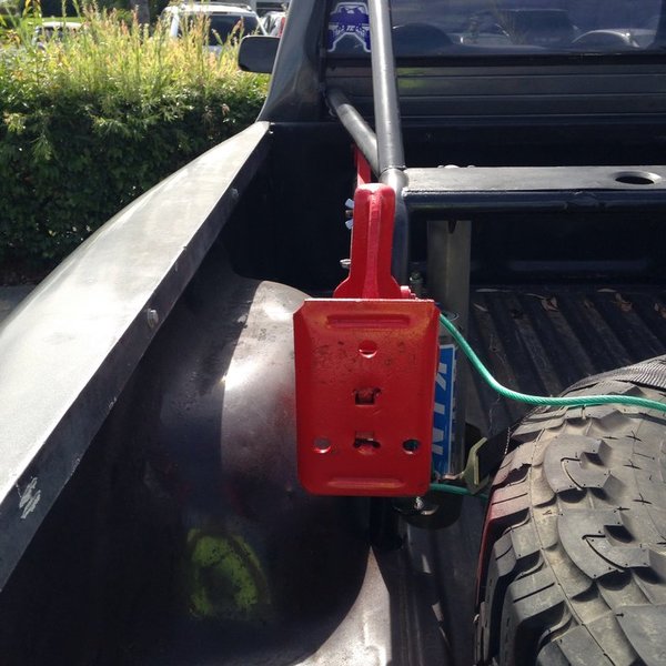

    Can you take a photo from the back, slightly looking down on the drivers side shock mount.

    It's hard to tell where the shock would come up...and how far out the shock would mount from the original hoops...the original hoops land straight on top of the frame

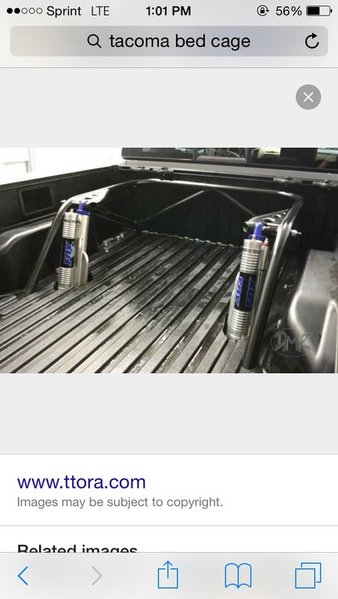

    Saw this, maybe like that but going out instead of in
    I like the hoops you made on the engine cage for the ranger...was thinking about something like that
