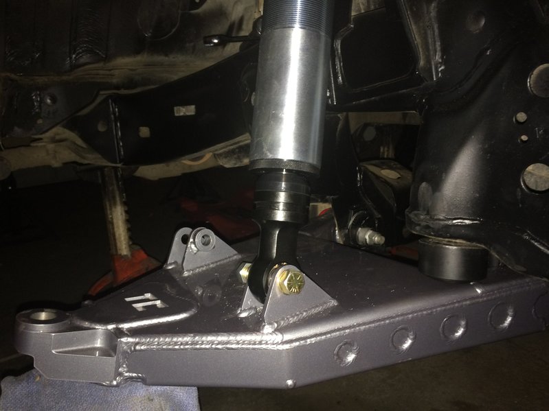

    So I am cycling my front right now. I have about 1/8" of shaft showing at bump. But that is just compressed with a jack not an impact compression. Everything is new. Nothing is broken. Should I lower my bumps a little more?

    You should be fine since it looks like you've got a rubber spacer in there sitting on your rod end, so really you have like half inch or so. Depends on your bump too, is it pretty hard like a stock bump? My superbumps would compress that far...

    I do have a rubber stopper there on the end of the shaft. If I lift the jack any more it lifts the truck off the Jack stands and compresses a little more not much. No motor or tranny in the truck. The bumps are Daystar that I got off poly performance.

    Where is the spring bottom plate? You need to cycle with the bottom plate in because it consumes like 1/2" of shaft.

    On the table. :p shit! Ok when I get home I'll throw it on. Good thing I'm double checking with you guys. I had the spring removed at a buddy's house. I honestly didn't know it had to be on.

    I don't believe it does on those shocks. It's held in by clips and sits flush. Now a king is a different story

    Finialy got home to check the bottom plate. DMCtacoma is right. It's just two silver clips held together with an Oring that fastens the bottom plate to the lower bump on the shaft in the the pic I posted earlier. The bottom plate doesn't touch that shaft at all.
    Edit: Another thing. I'm planing on using the TC limit straps that came with the kit. How much should I expect them to stretch? 1/4",1/2" or so?
