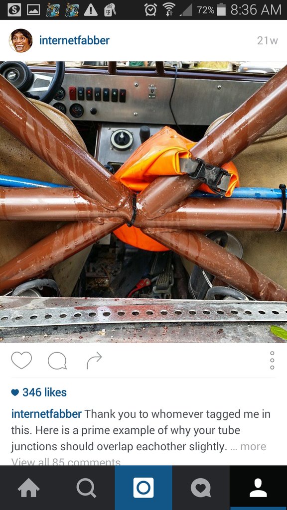

    Your painted lines look great. That cage should have been built with those tubes added, and your two tubes that meets in the middle really should have met at a junction and not been separated by that three to four inches. You can get away with doing this small boxed in section to tie those in better. This is what can happen when those tubes don't meet each other.
    And those tubes were only about three quarters of an inch apart.
