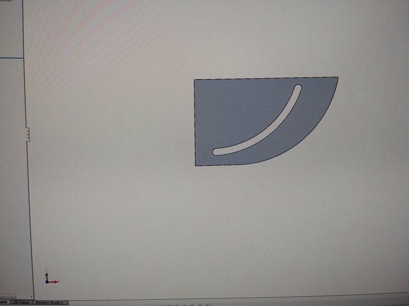

  12. Nov 5, 2015 at 12:35 PM
    MadTaco461
    MadTaco461 BRO runner
    Dec 30, 2009
    #28470
    13,426
    CA
    99 turbo 5 lug long travel
    Kinda stock
    Poor screen shot, but you could make your slot follow a profile

  13. Nov 5, 2015 at 12:52 PM
    Basikbiker
    Basikbiker Well-Known Member
    Sep 21, 2013
    #112968
    3,987
    Trav
    09 AccCab 4x4 spaceship
    My doors are the only stock things left besides the headlights
    now were cookin with gasoline! lol I think the arc really plays in the affect of how torque makesyour suspension either squat... inverted shackle design, or top out... conventional. soo with that would say flipping that arc around simulate an inverted shackle type setup? also, would just a straight line parallel to the frame be a sufficient middle ground? I could see an axle wrap issue possibly( ive been thinking about adding a traction bar too to mainly be a driveline skid lol, but that could help with the possible issue

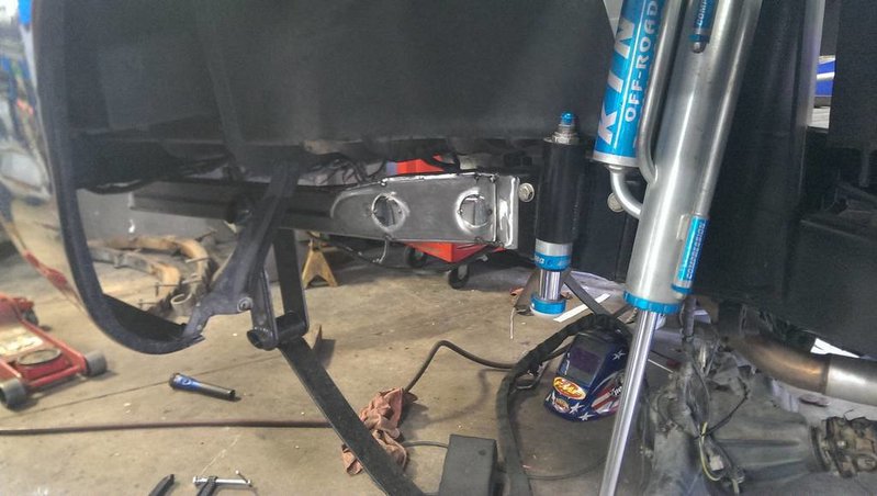

  14. Nov 5, 2015 at 12:54 PM
    lembowski
    lembowski Well-Known Member
    Jul 29, 2009
    #20347
    6,882
    Rolando, CA
    Jeeper Creeper
    anthony250f likes this.
  15. Nov 5, 2015 at 12:54 PM
    Basikbiker
    Sep 21, 2013
    #112968
    3,987
    Trav
    and again I can be completely wrong about all this stuff just trying to shoot ideas I got off you guys. cause if I convince myself enough, ill make this shit
  16. Nov 5, 2015 at 12:56 PM
    Basikbiker
    Sep 21, 2013
    #112968
    3,987
    Trav
    you just chop off the back 2 feet and put square tube in there?
  17. Nov 5, 2015 at 12:59 PM
    lembowski
    Jul 29, 2009
    #20347
    6,882
    Rolando, CA
    Jeeper Creeper
    A little more than 2ft, but thats the idea.
    FlapJack935 likes this.
  18. Nov 5, 2015 at 12:59 PM
    VolcomTacoma
    VolcomTacoma Well-Known Member
    May 25, 2011
    #57205
    20,617
    Jeff
    NorCal
    2015 TRD Sport 4x4 6 Speed Supercharged
    Front- Camburg 4x4 Long Travel 2.5" King Coilovers 2.5" King Triple Bypasses Wheelers Superbumps Rear- DMZ SUA 16" 3.0 King Triple Bypasses 3" 2.0 Fox bumps Wheels and Tires- 295/75/16 Toyo ATII XTREME SCS SR8 Dark Matte Bronze 16" Lighting- (2) 30" Combo light bars (4) Iggycorp diffused pods Tepui Ayer TRD Supercharger URD Mark III 3" Exhaust URD 4x4 Y Pipe URD CAI URD 2.85 Stealth Pulley Hurst Core Shifter with Hurst T URD Stage 3 clutch URD Lightweight flywheel URD Throw out bearing upgrade AEM Wideband AFR Gauge Speedhut Boost Gauge Craven Speed Flex Pod mount Weathertech Floor Liners BAMF Sliders Ultragauge sPod SE ARB CKMTA12 Hella Supertone horns Relentless Tailgate Reinforcement
    I think Matt's entire frame from cab back was chopped and replaced? @lembowski
    edit: nvm that was NFS
  19. Nov 5, 2015 at 1:00 PM
    lembowski
    Jul 29, 2009
    #20347
    6,882
    Rolando, CA
    Jeeper Creeper
    Just at the bump stop.
