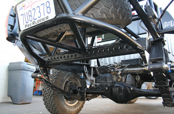

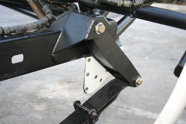

    @Basikbiker Traction bar is kinda difficult on long travel leaves with the driveline plunge you get. You could run a stiff pack and use the shackle/ slider to take away from the spring rate. My spring perch is almost as long as my bash plate. That will help with axle wrap. I basically did small tricks to make it more difficult to wrap the leaves. Also you might want the way I drew my slot because that will make your rear end rise to help push you forward

    I don't see how yours are a sliding shackle. Looks solid to me just an arch plate on the one side..

    He just showing how he did a regular swing style shackle on a 2nd gen offset from the frame. We were talking about ground clearance earlier when crawling

    And I was thinking the slide action would act more like a link/coilover type setup since it would probably flex less and a more linear spring growth instead of being on a swing type pivot, because doe sent shackle position in relation to the spring somewhat have an effect on the rate?
