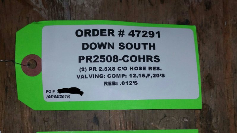

    it means that the first two shims are lighter than the rest of the stack, and that between those shim and the remainder of the stack is a flutter shim that allows the first two shims to flex a little more before coming in to contact with the stack. it means that the initial will be lighter than the mid/high speed. valving is based off of shaft speeds. so slow or street driving will be comfortable and then it will ramp up as you start hitting bigger/faster speed hits.

    my tag is 12,12,F,W/full stack 20's/12R

    Dsm didn't send tags with my coilovers or my rear shocks :(

    Sound good for a single c/o

    the shocks you bought in 7/2014' are fox specific shocks for the 5 lug Tacoma. we didn't set them up.
    single front shock :thumbsup:

    I thought you guys added a flutter or something. Truck handles and rides great so I'm not complaining. Although, I'm curious what valving is in the rear.

    maybe? but if we did its not noted on your invoice.
