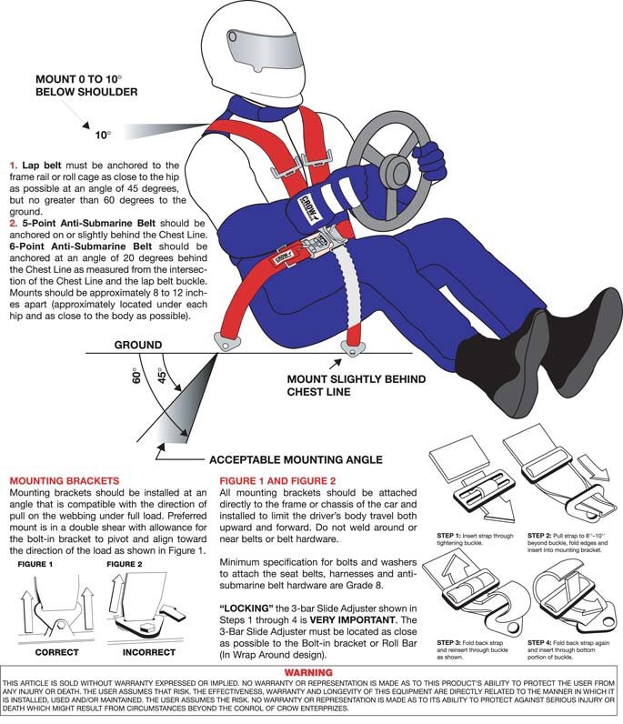

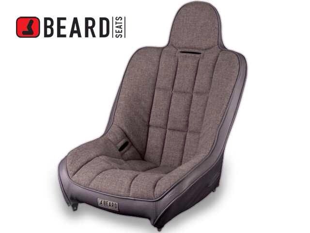

    Should I route my harnesses through the slot under the head rest? Also been reading on other forums that the harness bar should be above your shoulders or level?? I thought slighty below. Mine is slightly above and I feel like it makes it so I can move up out of my seat a little too much

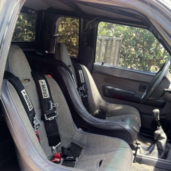

    image.jpg Seats look like this

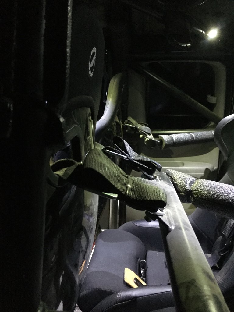

    Needs to be below
    How I mounted mine
    doyouevenprerun and nfs257 like this.

    Are your seats on a slider?
    Hmm that's intersting the way the harness bar is. I like it though

    No they are solid mounted. I did the harness mounts that way because of the 3rd seat.

    Should I go through that hole in the seat or like this? I get tired of fishing my harness from behind the seats..lol

    Not a fan of the single hole seats but it's better then the harness slipping down the side of the seat in an accident

    not really a fan either, i want new seats but i want ones that dont sit any higher than these. Yeah i noticed that it feels like they wanna slip .

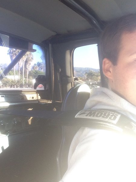

    I guess the harnesses are almost 0 degrees...but the harnesses aren't long enough to go through the hole in the seats and reach the c pillar lol
