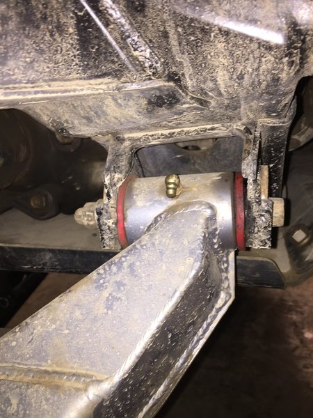

    Don't think I ever posted this pic in here... Remember when I was installing LT and couldn't get my stupid Driver side LCA in? Well I beat the crap out of the mounts and barely made it wedge in there. Now it's destroying my bushing on one side and not touching the other side...

    You might have to spread that lower a bit.

    Is that a thing? I figured it couldn't be bent frame because the distance between the mounts was too far... Don't see how that could happen. Yet I don't see how a total chaos LCA wouldn't be perfect size...

    Things move when you weld them, and most of the jigs for LT kits are on the tight side from what I have seen.

    That problem has been posted a few time with TC lowers, that is way out of spec though. Don't mean to sound rude but you really should have returned those to TC and not installed them... have you tried calling them and sending them that photo ? Maybe they would be willing to help you with it ?

    Fuck are you serious? I figured they would have just said, nope your frame is bent. See ya

    Both kits could very likely come out of the same LCA jig, your kit is nice just an anomaly issue with something out of spec a bit. You should give them a call today and describe the issue to them and send them the photos. Best case scenario is that they may send you a replacement with a deposit then have you ship back the bad one ?
