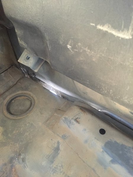

    Yes....): looks like it was a pinch weld maybe

    are your seats mounted to tubes, or into the cab?

    16,775
    Anthony
    San Diego, CA
    2008 dcsb trd offroad 4wd
    Mounted to the cage

    1,623
    MT
    First Gen Tundra
    First Gen Tundra Linked and Long Travel
    what's even back there? maybe the cab needs more plating to the cage?

    16,775
    Anthony
    San Diego, CA
    The guy before me had a battery and a sub and it kinda crushed the floor so I think that's why...I think so too, I just can't stand Welding that thin shit. Still need to connect the c pillar to the frame

    16,775
    Anthony
    San Diego, CA
    I have nothing back there now

    3,958
    san diego
    1996 tacoma 4cyl, 5spd
    Plate it. These cabs split. You can plate it with 12 or 14 gauge to keep it from spreading.

    16,775
    Anthony
    San Diego, CA
    If I plate it in will it continue to spread to the other side ?

    #27296
    3,958
    san diego
    I'd plate all the way across the back along the seam.

    16,775
    Anthony
    San Diego, CA
    Even though it only goes for about 8 inches? It stops at the hump in the middle
    Would you plate it by just laying a plate flat on the ground and butting it up against the wall?

    #73066
    16,775
    Anthony
    San Diego, CA

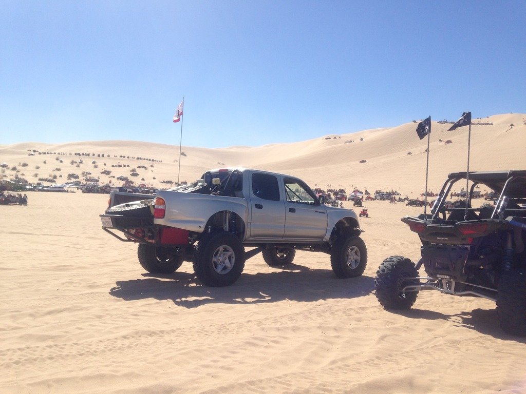

    just got a simple lift on her
    oh dude i have for sure seen you. i drool over your truck haha!!
    were you camped in wash 4 on halloween?
    theres another truck that looks just like yours out there all the time i think as well.
  16. Nov 16, 2015 at 8:46 AM

    11,968
    The moon
    50 shades of tan©
    Tacoma with some stuff melted to it
    Is that before or after the cage? Mine was splitting pretty bad before I caged it, but when I caged it I just sealed it and it stopped. How many spots is the cage plated to the cab?

    16,775
    Anthony
    San Diego, CA
    I think it happened before...it wa alike that before I got the truck...it's played at the a pillar and the b pillar...also in the 4 spots it goes through the floor...and also 4 times in the back where the tubes connect to the bedcage....I'm trying to figure out where to even land my c pillar...was considering removing the body mount, welding a plate on top and landing it there

    Thanks! Yep that's where I was at the socal tundra dudes were really close to us too. You were flying right by our camp haha. It might be bonzen I know he's usually out there.
    Seen a couple tacos over time even stock that start to crack/split all in the back of the cab but not not much.

    nice im always camped right there in wash 4. i was right on the other side of the tundras camp closer to the dunes. thats where ill be the whole week of thanksgiving as well!!
    yeah bonzens is the one i have seen out there most... but i have seen yours for sure. very very similar trucks haha.
