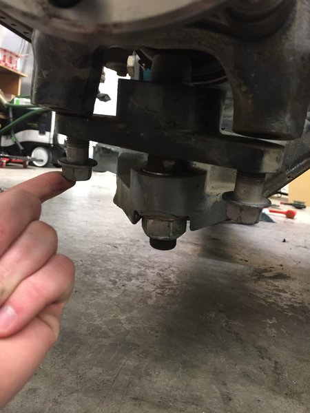

    Anybody have any input? Got the new boots on and I'm ready to wrap this up...

    All the axles I have done have had a little bit of play in the tripod. So I'm going to say that's normal.

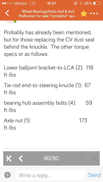

    What are you guys torquing these to? Think I did 80. Both sides were scary loose...

    118 ft/Lb

    Tight is tight, too tight is two pieces. Red locktite is your friend
