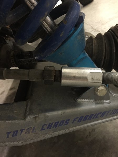

    Did anyone else have to cut down their tie rod extensions? Looks like I'm going to have to cut down the threads coming off the inner too... Seems like a cutout wheel is gonna ruin the threads...
    This is right after I cut it down. Haven't touched the lock nut

    Wait..what !? Why would you have to cut those ? Post another photo wider angle so we can see from your inner tie rod all the way to the outer at the spindle

    Funny story. I'm a dumbass. Didn't need to cut down the threads (AND I DIDNT). I was just screwing it on by hand and it would stop once it got the threads that hadn't been touched yet, it wasn't bottoming out. Now I should be able to get an allignment.

    Ah cool, glad you didn't chop anything. BTW If you ever plan on getting those spindle bolts back off again with a torch don't use red loctite, blue and proper torque spec will do the job.

    Yeah, I chopped the extensions but not the tie rod itself!
    Yeah I was gonna just do a little bit of blue and proper torque spec. My stupid jeeper best friend always gives me crap about torquing stuff to spec and said "80 is like insanely tight! Do that!" :rolleyes:

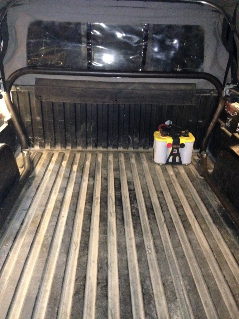

    Got another tube bent :) so far the space saver part of the plan is still workin lol
