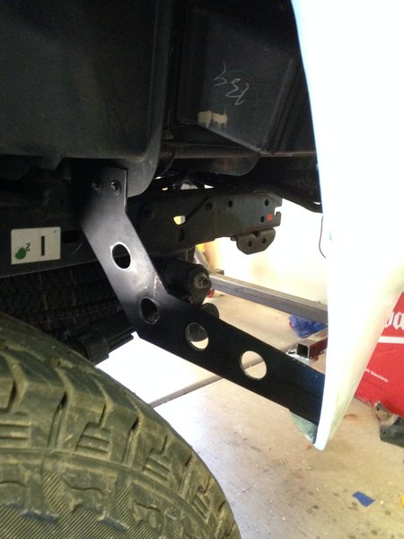

    Is it normal for bedsides to spider crack? Mine have them all over and will be some serious body work to get rid of them before I paint

    Are there Enought mounts? They sound like they are flexing too much

    Solo motorsports XLT LT, foxshox
