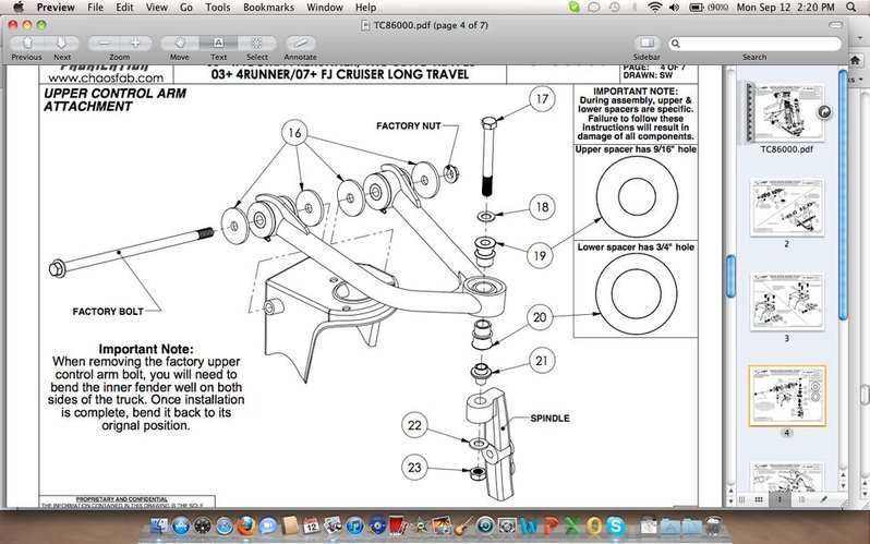

    Which uniball? what washers?

    the one on top of the uniball is the thin 9/16ths washer, the bottom is the thicker 3/4 washer

    Nope you shouldn't have washers on you uniballs. You have aftermarket spindles so you don't have the slug adapters

    Yes and you're question has been answered. Smaller one on top, larger one on bottom.

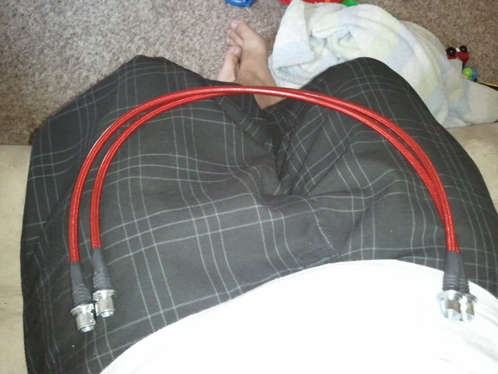

    UPS just stopped by..
    Got my custom length stainless steel braided brake lines..
    Install and testing tomorrow night..
