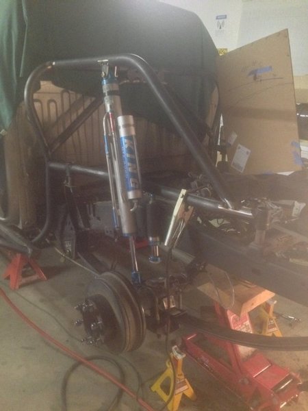

    Does your bed cage tie into your sliders? It looks like a bolt in bed cage so I'm questioning on whether or not It really attaches to your sliders or not.

    It does tie into the sliders....tube couplers in there
