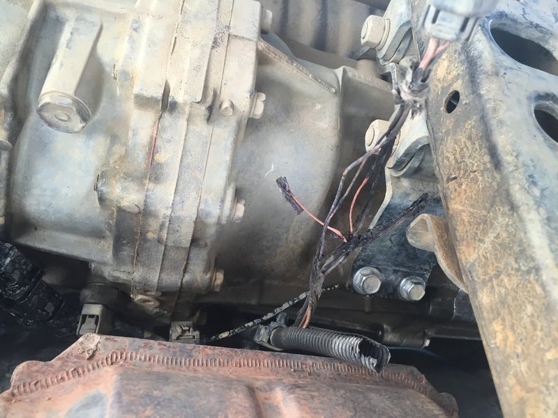

  18. Feb 3, 2016 at 12:26 PM
    Rakso
    Rakso CeRaTi
    Feb 26, 2009
    #14105
    9,665
    OsKaR
    Cali
    09 PreRunner
    LSK LT in Progress, custom bed cage, DMZ SUA kit with 2.5 kings triple bypass, kings bump stops, baja bumper, rear custom tube bumper, glass all around, Weather Tech Liners, wet okole seat covers, Cluster LED Swap, HU LED Swap, hood LEDs, bed LEDs, etc etc etc
    Yes I have stock axle with shocks outside frame. Thanks for the info.
  19. Feb 3, 2016 at 12:53 PM
    anthony250f
    anthony250f Well-Known Member
    Feb 18, 2012
    #73066
    16,777
    Anthony
    San Diego, CA
    2008 dcsb trd offroad 4wd
    Well took about 10 mins to find. Blew the efi fuse and this
    nfs257 and SilverGhost like this.
  20. Feb 3, 2016 at 12:53 PM
    Blackdawg
    Blackdawg Dr. Frankenstein
    Dec 31, 2010
    #48500
    81,631
    Monte
    Wyoming/St. Louis
    The Trifecta of Taco's
    Wow wtf is that shit?
    anthony250f likes this.
