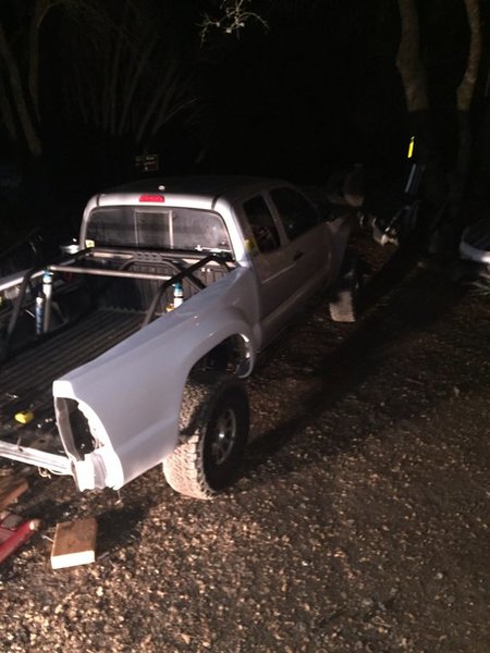

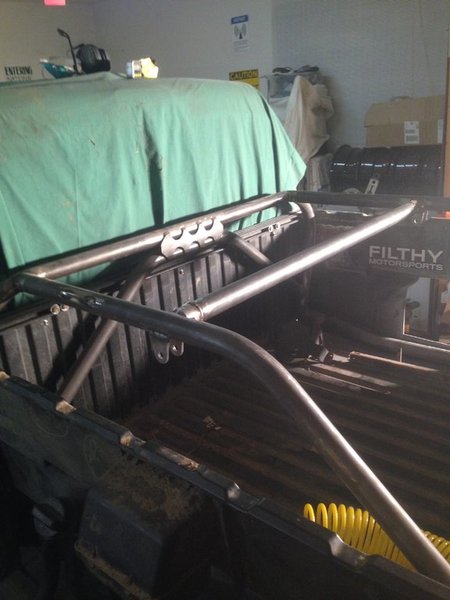

    Got more shit done today
    The center bar unbolts too

    LSK LT in Progress, custom bed cage, DMZ SUA kit with 2.5 kings triple bypass, kings bump stops, baja bumper, rear custom tube bumper, glass all around, Weather Tech Liners, wet okole seat covers, Cluster LED Swap, HU LED Swap, hood LEDs, bed LEDs, etc etc etc

    Made progress last night
