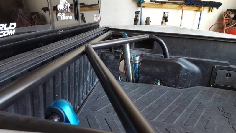

    :eek:Oh my gosh...bro they blew up your diff thrashing it ( probably locked ) on a test drive and mounted your shocks single shear like that !? Really hope they make it all right for you man.

    Thanks, it really sucks when they tell you they've done several truck setups like mine, I even gave/showed them specific pics of what I wanted and how I wanted the whole thing. It's missing the top plates and the cross tubes from the center to the frame. LOL what a joke.

    Also did they have your d shaft modded ??

    No they didn't. What mod is required?

    ...too much shit to list.
    A slip yoke if you're pulling any decent amount of travel.

    Needs a slip yoke added

    You can still strap it at like 16" of travel if you want to wait for driveline mods, thats what I did, of course if you have the money get it modded at the same time, just tell them you want the rear shock mounts double shear, shouldnt be an issue to fix, without close up pics the rest of the work looks decently clean.

    It is strapped at 16"

    2wd 2nd gens can pull 16" without driveshaft modifications?

    whats the cost to get a slip yoke?

    About $600 to $1200 depending on what you need done.

    2nd gens don't come with slip yokes?

    2nd gen 4x4's do

    Costed me like 300$
    I couldn't even pull 13" without needing it ...
