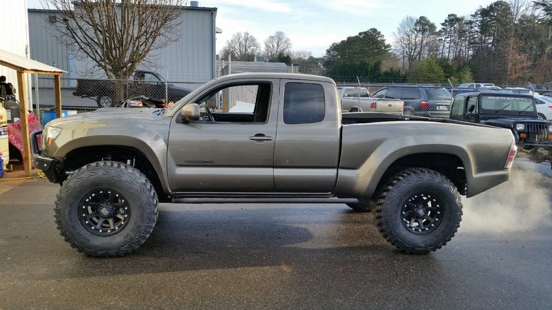

    Damn... That's sexy.

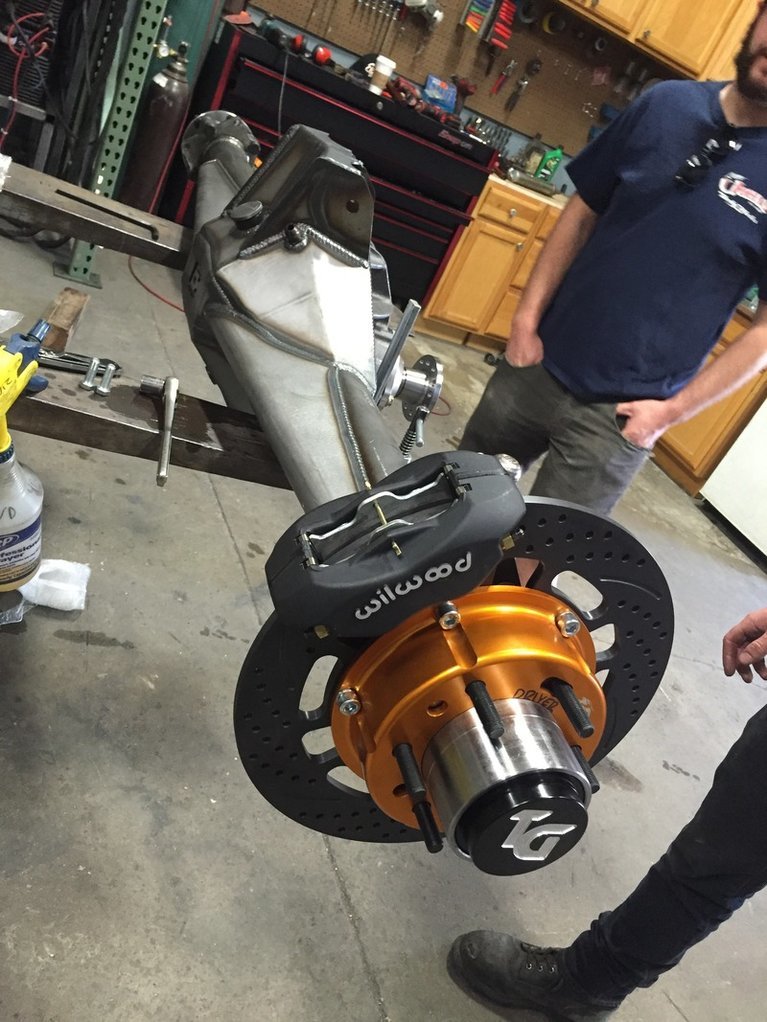

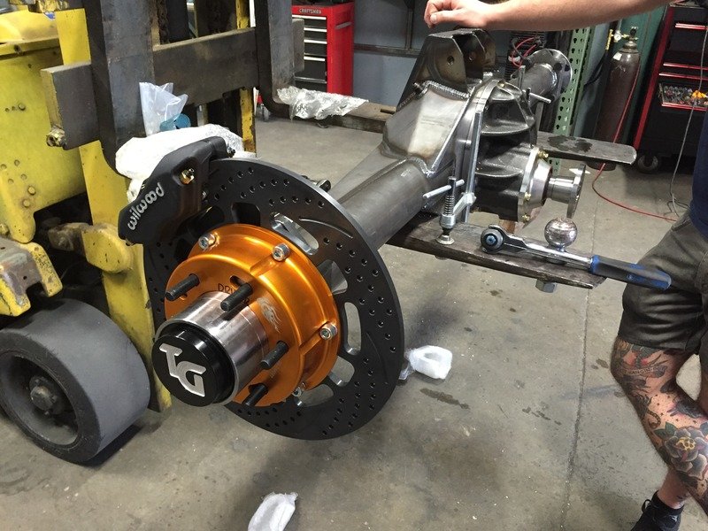

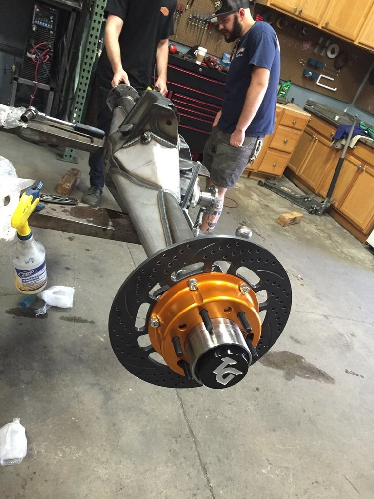

    Threw it all together, and shit actually worked together. Huh.

    Damn that's sexy!

    What are the specs on the axle man? Was looking at something similar.

    Camburg housing, nodular iron 3.25" carrier, Detroit 35 spline locker, Daytona pinion support, 5.29 Yukon gears, Currie f450 hub pockets, trail gear d60 hubs, trail gear brake kit, trail gear axles.
    Probably cheaper to get a complete roller from trail gear, or at least do all the components from one company. I got lucky that it all seems to be working together with minor adjustments.
