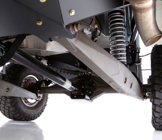

    Just out of curiosity, not talking shit lol, Is it normal to have the link mounts on the axle hanging down so low? Seems like you'd want them horizontal with the axle?

    From my understanding and reading it has to do with the geometry.

    They can be setup either way. I've found it easier to control driveshaft plunge, as well as keep a better pinion angle with the tabs below the axle tube. It's also easier to get the anti squat numbers I'm looking for.
