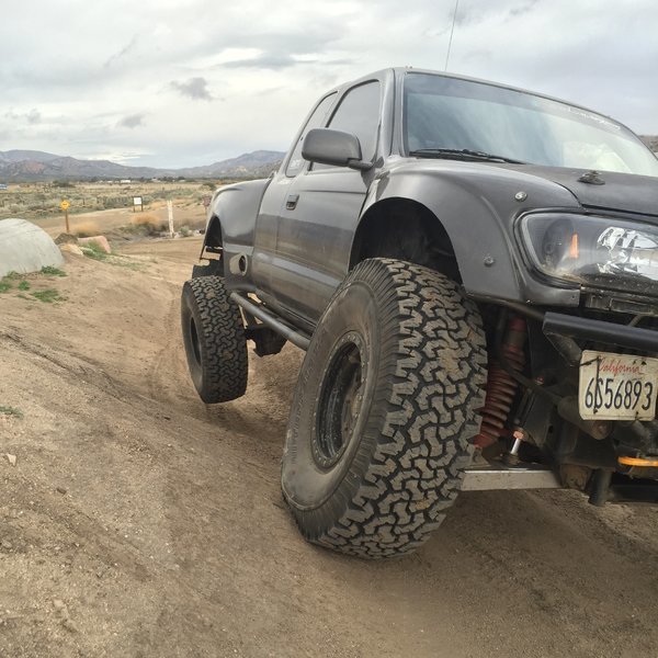

    Hmmmm could be an option. Got any pics of them with 35s??

    Kinda stock
    None of these guys can fit these big brakes in 15s
