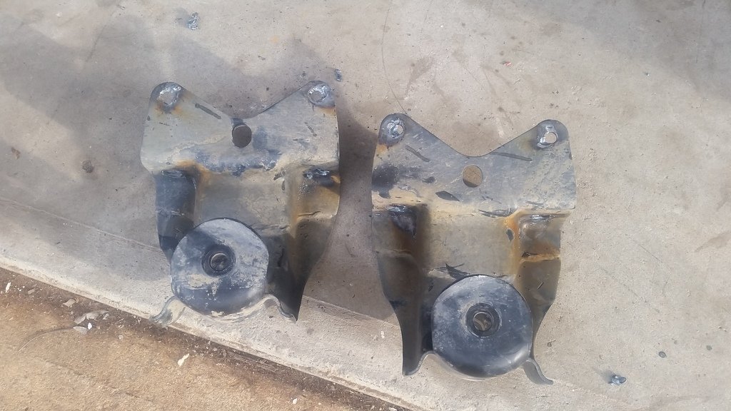

    I just cut these off of a customer's truck.

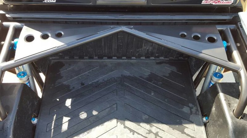

    spit cup, weathertech floor mats, riffle rack, and bilsteins.
    perfect!

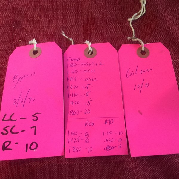

    Need help tuning triple bypass shocks, when I get into bigger size whoops I bottom Out. Do I adjust the shorter tube or long tube of the compression side?

    Short one closer to the top, any idea what valving is in it right now?

    First tag is the rear bypass, then front bypass and coilover

    Front tubes are set at LC-5, SC-7 R-6

    Looks like a good starting point without knowing the details on the truck, I'd try closing the too short comp tube at least 3/4 the way in, more if needed. If you get to the point that it's all the way closed and you need more, then time to step it up on the comp valving shims

    Ok I'll try that and see how it does, thanks for the help!
