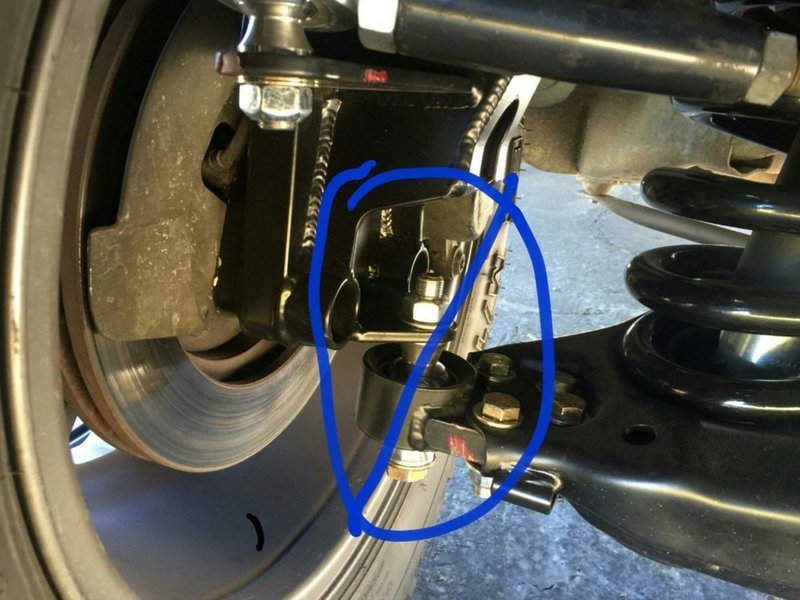

    Is that a lower uniball cup bolted into a stock lower control arm? Im confused

    yes, but not uncommon for cars and trucks to have the ball joint adapter actually a bolt on piece to the LCA. I'm pretty sure that what everyone is reacting too is that the uniball attached to the spindle single shear just to that one tab on the spindle.
