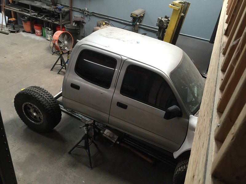

    Progress is slow, but it's still progress. Trying to get it "done" for the April 16 SoCal Offroad trucks meet in Barstow.
    03E7A6C1-7E2F-4BDB-A19E-6A0E20C03F45_zps_a16f8df8b0ae16042fd724c2cef11824998aca3c.jpg
    Unplug it or pull the fuse
