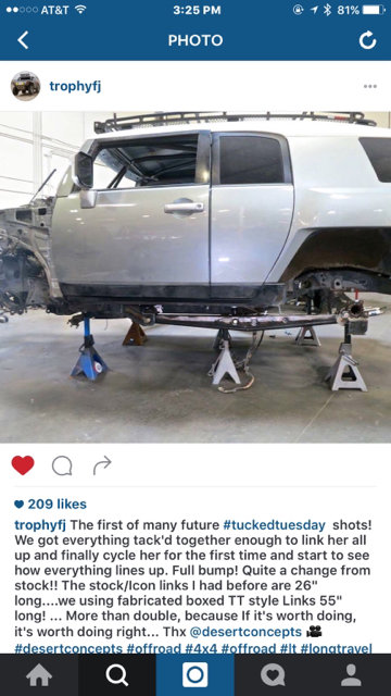

    I don't know how much longer these links could be

  6. Apr 5, 2016 at 5:02 PM

    1996 Toyota 4Runner
    If you think that's insane go look at his front arms

    It really messes with your eyes looking at those links starting under the center of the driver seat and see so much cab behind it.

    Can anyone explain where the front link pivot point should be on this FJ? Not talking shit but have no idea myself. Link geometry and setup is like Swahili to me.

    1996 Toyota 4Runner
    There is really no "correct" placement. It's just weird seeing such a long link on a short wheel base vehicle.

    Kinda stock
    There really isn't a specific point they need to be. He is using a 55" link and keeping the stock wheel location. That spot on the lower frame is where the link ends. The longer link is going to help his straight line stability, but he still has a short wheel base. land the upper link to how you want. After that things like drive shaft and wheel base would be where to strap the links.

    allpro long travel, shackle flip with ome dakars, cruisin offroad bumpers and sliders, 4.88 gears with arb's front and rear, budbuilt skids.
    Isn't bj baldwins blazer pretty similar? Short wheel base and long links.

    2019 Ford Raptor
    So a 48" link might be better for this?

    Kinda stock
    You can run long links and be just fine. You'll get better straight line stability with the 55 over the 48 and a bit more travel. This is looking at it with prerunning in mind. You can run really long links on a short truck. You just can't droop it out like crazy.

    '99 Trd Xtra Cab 4x4 5sp
    Is that because of the driveshaft?

    '06 4x4 AP LT and Locked
    He's going to drag those links like a mofo if he hits any sort of trails.

    1996 Toyota 4Runner
    Currently it's just being built for recreational use.

    Kinda stock
    That might be right where his transmission ends. Hard to tell. But also when you air out and try to land with your wheels dropped down really far seems kinda sketchy for going into a roll if you get too off axis. It's a big top heavy suv. Just my opinion. I'm not too familiar with short vehicles.
