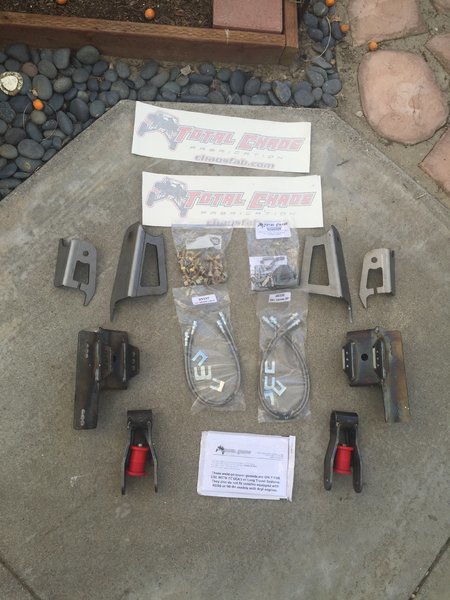

    truck parts are always so pretty

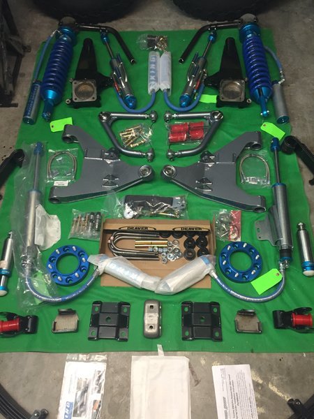

    Let me just get you my address for those secondaries, lca's, and bumps

    Specs? Looks awesome!!:thumbsup:

    Looks like the TC +2 kit. I talked to TC last week while ordering some stuff for customers builds and the said that the 3.5 race lowers are still in the testing phase and won't be available for a few months

    i was wondering when TC was finally going to use a built in uni-ball on the LT kits. the bolt on one always bugged me for some reason

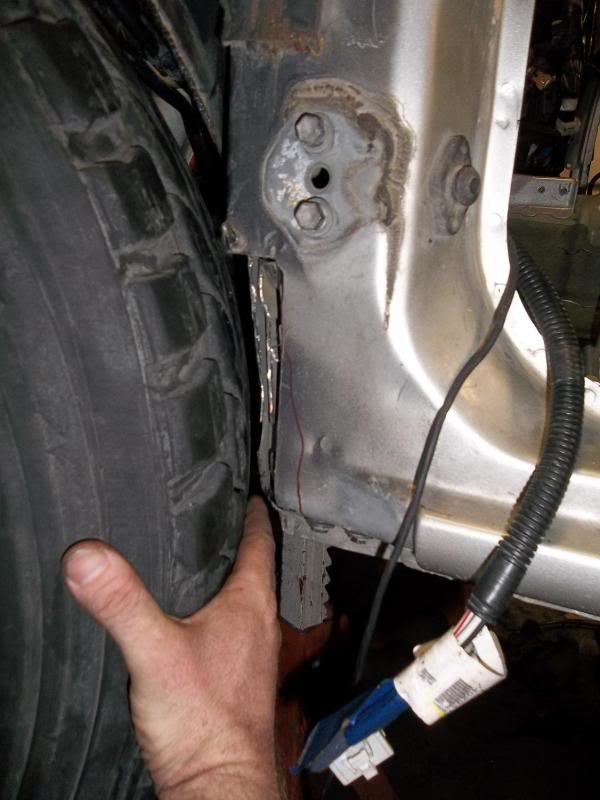

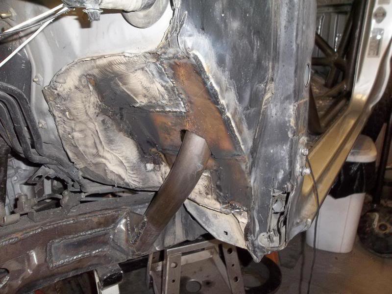

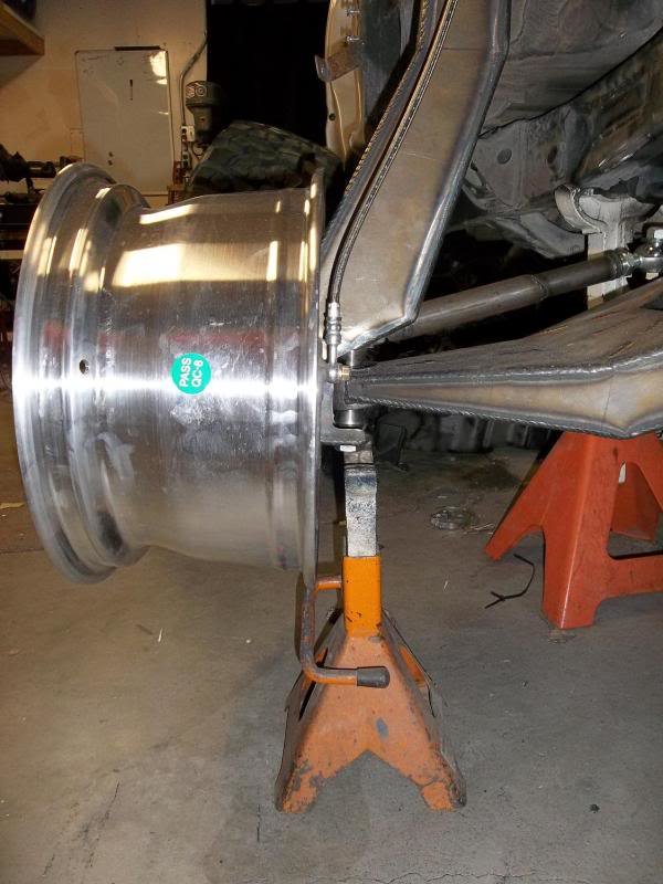

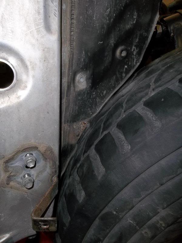

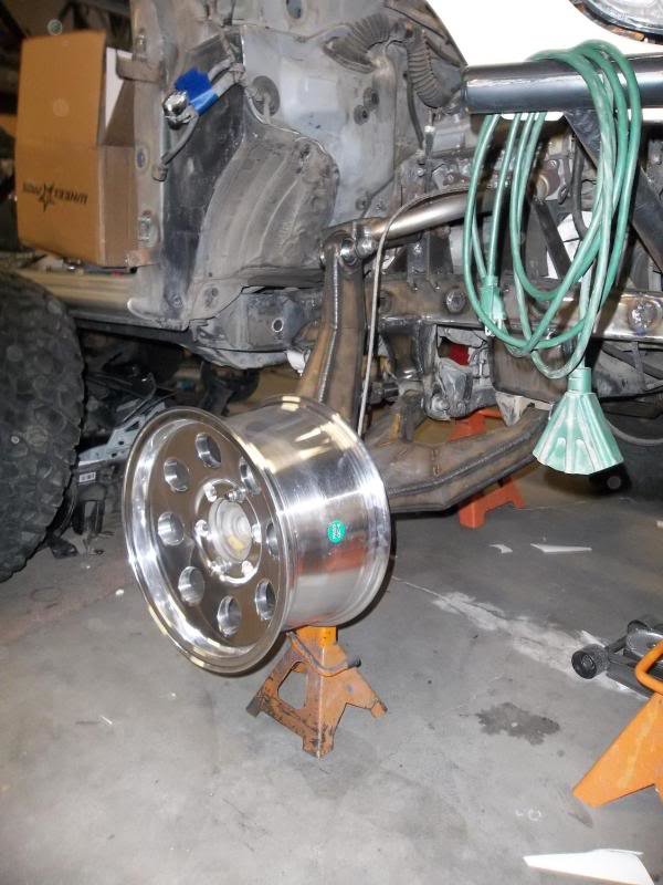

    True but assuming his kit is the same one we're racing on ours are tucked in pretty far with the offset we run to work with the kit's geometry.
    You can see, our entire brake caliper is inset in the wheel...

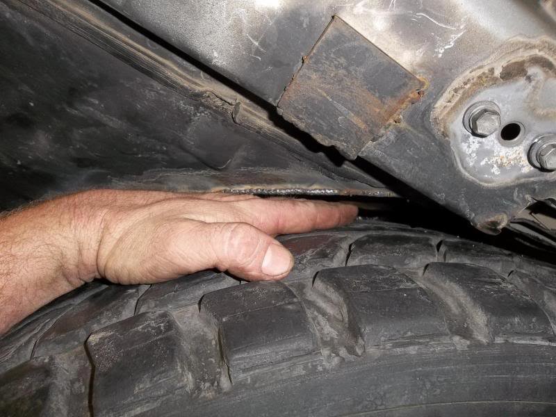

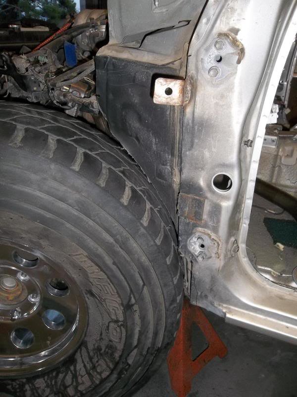

    It's not done yet in those pictures but I did have to clearance the bottom corner of the firewall where it transitions to the floor board portion. It wasn't much but at full lock and full bump with 35" projects mounted that I was cycling with at the time it did hit.
    All said and done clearance wise...
    Ain't sexy but it wasn't finished either...
    It's worth it, remember what I said though, speed is not his strong suit unfortunately, LOL, never has been! Sorry if you see this Matt but you know it's the truth!!! The kit is badass though!
    I'm really curious to see what you come up with for an upper mount on the driver's side! In my head I'm wondering if you're planning to relocate the whole brake system to a remote setup or something? That or you're one crafty dude!!!!
