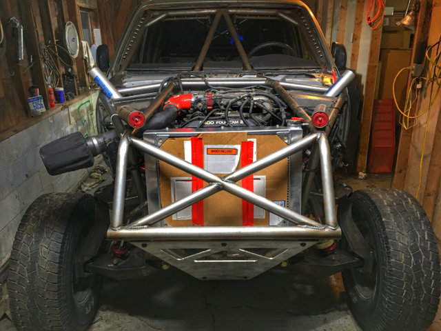

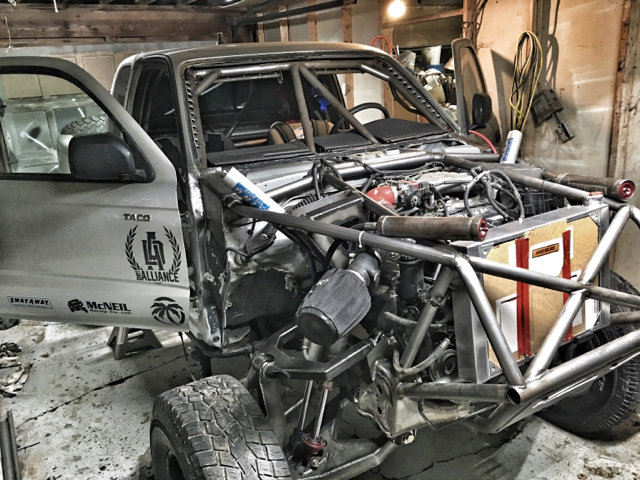

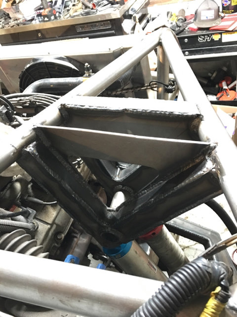

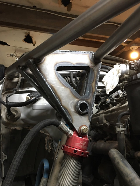

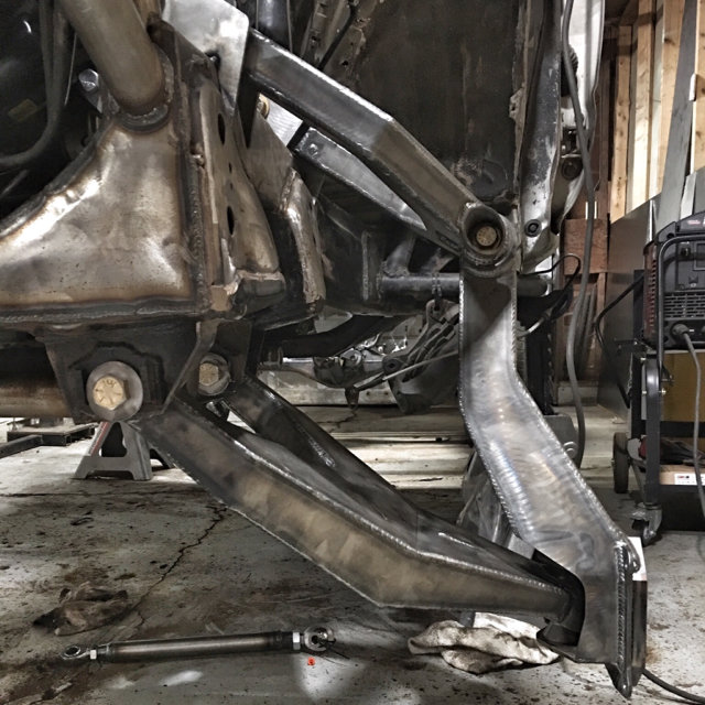

    Hey guys, somewhat new to the forums. Figured I would post some photos of the latest upgrades to my gen 1. Two weeks ago I received my new front kit from TT Motorsports. New uppers, lowers, spindles and steering. This kit is replacing a kit that I had made about 8 years ago but was time to step up the travel numbers and add quite a bit of strength. Along with a bunch of other upgrades, the goal is to have everything complete for the Silver alike Prerunner Invasion here in Michigan May 14th.

    I'm curious about the significance for that single plate, as apposed to another boxed section ?

    I designed everything on the driver side where the brake booster/ master cylinder was. The master would hit if I ran the rear most plate across the top on the bypass mount like I did on the coilover. In hindsight, I should have just eliminated the plate across the top on all four pieces, which is how they are set up on Tommy's truck so it looked a little better but it did give me an area to mount some of the under hood stuff so I'm not too bummed. Did that answer your question or did I miss the point?
