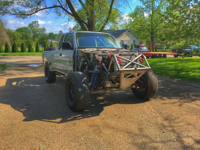

    Slow start. Still cutting stuff out. Just cut off a section of the dash bar. Chopped off front body mounts. I need to cut open the floor to land the A pillar and also the core support is getting chopped off to poke a tube on each otter edge outside the windshield wipers. I hopefully shouldn't lose any AC vents either. Hoping for a tight fit. This is when I wished I had a plasma

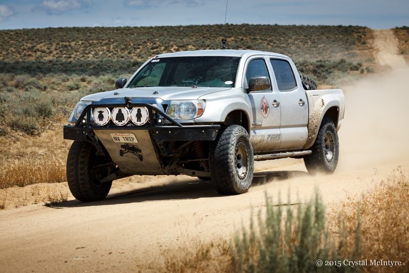

    I cut a piece of TAP plastic for the area and used 3M molding tape to secure it. This stuff takes a beating!
    Edit. Can't tell by this picture...it's covered with mud.

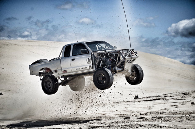

    Figured I'd post a few photos and a recap from the weekend. Got the truck finished Thursday and took her for a test run around the block and hit the few speed bumps...pretty uneventful so I was a bit nervous hitting the dunes
    Got to the dunes early afternoon Friday and did a shakedown run. The temp sensor for the radiator fan wasn't working so I ended up just hard wiring and ran it off a switch. Did a few laps and immediately knew the hard work was worth ithttps://vimeo.com/167019373 but the rear end definitely needs to be addressed. The 10 year old deavers in the rear are pretty clapped out.
    Saturday was the big day, had a great turnout

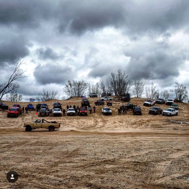

    2e0fa3bc4366c6bb9c3148232503c218_cee22c9c505281b99b77bcf4b2f51e3c0df3cd56.jpg. This picture says it all, the weather was shitty but the turnout was great. Vehicles ranging from full built prerunners to this rusty truck doing about 60 through the whoops. Everyone is here because they all share the same interests...no one talks shit about other people's trucks, it's a really positive group of people which was cool coming from the west coast where everyone's ego and social media fame gets in the way of doing what we came out here to do. Anyway, ran the most laps I've ever ran and drove my truck harder than ever before. Let's just say this new front end is ridiculous. If any of you guys are looking to upgrade your gen 1 front end, hit up TT Motorsports. Here's a few more photos from the weekend, more to come in the next coming months
