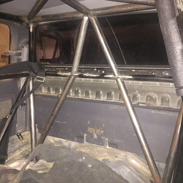

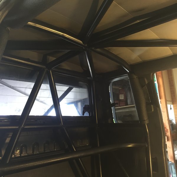

    None taken, that's the thing is this is my first cage and I've heard of people going to the floor and I know the frame is better. I should've asked how you guys went to the frame. Did you use a gasket on the floor for the pipe to go through? I'm having a friend that's done a shit ton of cages help me but he's never done and internal, he just makes strictly off road trucks that don't have cabs.

    I cut a big square . Welded the tube . Then plated it in with 16g....use cardboard templates lol

    Did you use a rubber bushing or anything. If not, does the cage vibrate.

    The cab is tied to the cage in multiple places. You could say it's loud lol
