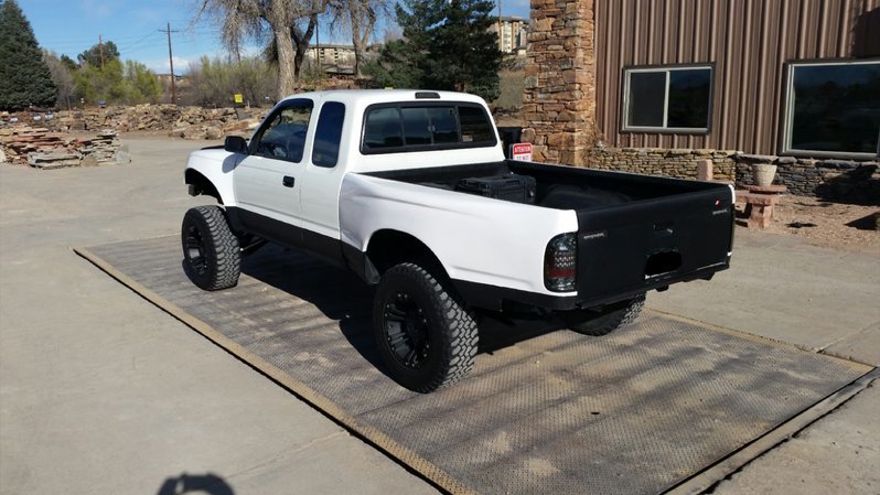

    A good place for a scale is a quarry or place that sells rock for landscaping. My 1st gen came in at 3800lbs. Empty was 4220 but we had 2 of us in the cab so minus 400lbs.
