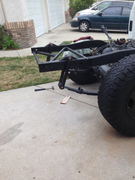

    does anyone know if total chaos shackles are supposed pair up a certain way? Mine are crooked as shit and then i set them on a flat surface you can tell they are bent??

    Yes they go a certain way lol....the top is wider than the leafs. They look like ( V )

    Looks like you didn't put the hanger on straight. Looks like the shackle is already rubbing the frame

    okay im gonna work on it now. mught be the angleof the picture the hangers are pretty straight and theres no rubbing

    Mines not even close to rubbing but when you flex/off-road it rubs lol

    hell yea!! got them all dialed in now haha i was working in this yesterday and it was pretty hot so i think it was messing with my head its pretty obvious how they are supposed to go

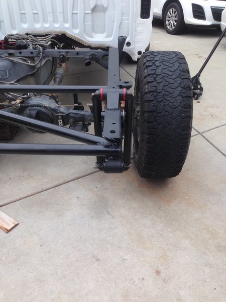

    this looks a little better hahha

    Why are the shackles vertical at ride height ?

    IMG_1318.jpg not vertical but definitely need more angle it was jacked up a little in the pic

    As long as it doesn't go backwards at full droop

    no full droop still stays positive when i buy new leafs ill have to redo them though.
