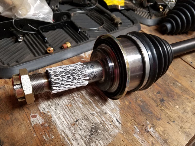

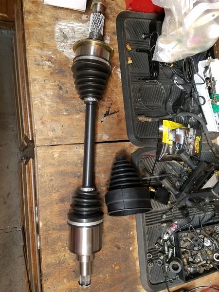

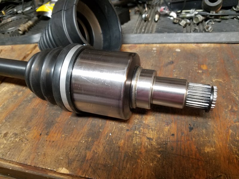

    It's always that little ass basket/cage that holds the ball bearings in that breaks. Seems like a poor design. Well this one will be the last until I figure something else out. Might look into genuine Toyota axles then if that's your suggestion Jason.

    I have the axles you show in your pic and using this boot. Needed to get a narrow clamp to have the boot seat correctly in the recess machined into the inner flange/cup. I have about 1000 miles on them, no problems thus far. Super easy to swap out.
    I had some trouble getting the new axle into the diff as the snap ring have a very shape edge to it versus the OEM snap rings which have a bit more rounded profile. I wound up just "kissing" the leading edge of the snap ring with a die grinder to chamfer the edge a bit. Worked perfect. Good luck

    Thanks for the info. Did you have to modify/grind the cup for the extra travel of our suspension or just put the boot on and go?
