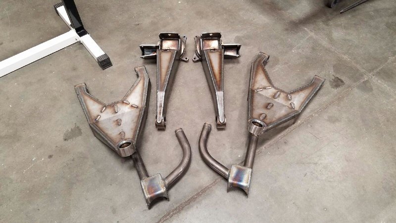

    Todd Walter has a really well built 2nd Gen (Adrenaline Motorsports Racing on FB) that is similiar to the TSA truck only leaf sprung...that truck will be racing 7100 starting at Blue Water later this year. Also Kurt Youngs little green Toyota just got a TC kit that he raced on at the Mint.
    Bottom line you aren't going to go wrong with either company and I'm willing to bet that performance wise 99.85% of the people who post here (myself included) would not be able to tell the difference between the two kits from behind the wheel.

    You're 100% right. Especially if you're paying someone to do the work for you. But for me the parts are already paid for. It's only my own time needed to try and squeeze as much out of my own kit as possible. Definitely not necessarily really more interested in seeing what's possible. Whether it's guns, tools or cars I like messing with stuff trying to see how much more can gotten out of them.

    That really won't help the 4x4 guys. Cv bind limits the droop. You may gain some bump, but you're gonna lose all of your inner fender wells. I think if you're gonna make the jump to 10" dual rates you might as well go solo xlt or trac once it's released. You'll also gain the ability to run more robust hubs

    That what it seemed like everyone was referring to since you really can't get too crazy on the droop. Adding longer arms is the only way to do that. I can agree with you on the amount of work needed when your uca starts knocking into the fender.

    No problem dude! This is the fun part of my job and I enjoy talking about this stuff. End of the day both companies make great kits and you cant go wrong either way, Hudson has had great things to say about their race kit and I think its a great design. Pat is a great dude as are the guys at Camburg.
    Lets see if I can cover most of what you asked.
    First thing to keep in mind here is that our numbers are off a Tundra, not a Tacoma and there are difference between the 2 and we have not done the side by side comparison on the Tacoma's. None of our Tundras are running a diff drop. The Icon Tundra shocks are built specific to the LT tundra kits. As I said and is shown the bigger difference in travel numbers is from shock selection. There are minor differences between the two kits which we can only chock up to small engineering difference between the two which accounts for the small discrepancies.
    On the Tacoma shocks from Icon that are for a 3.5 LT kit the bodies on the coilovers are shorter which in turn allows for more compression travel which is where we see the difference. My truck is getting a complete tear down and rebuild early august, so when I do I will grab a tape measure and cycle everything for you guys with complete numbers but they will be close to the Camburg/Icon combo. Not with a Kibbe tape measure either. 15 has always been my metal to metal estimate but even at full droop, limit straps off, my CVs do not bind, I'm strapped about an inch short of full droop right now.
    Now, that being said there are pros and cons to the additional uptravel I have on my truck. Any one that saw my truck at Rock Therapy will tell you that my inner fenders are pretty much destroyed, this is from years of self clearancing on 35s. I run a very soft and tall Timbren rubber bump up front. My truck will lay skid plate on the ground before I am truly at full bump, which is due in part to my skid plate design which we built a little lower than some to keep everything away from the diff. For situations like Rock Therapy or other slow crawly type stuff with lots of off camber and slow flexy stuff its awesome as the front end articulates side to side, big deep whoops and steep transitions where the front compresses at once not so much and I will sometimes clip the front corner of my lower skid plate. Alot of this can be accounted for in valving and bypass tuning.
    The heimed steering on my truck was done for a number of reasons mostly because I was properly set up for it with the double sheered outers on my spindles. Pros and cons again: Its highly unlikely that I will ever bend a .1" .095 Chromoly tie rod, but I'm also far more likely to blow up a steering rack now, which has been an on-going struggle.
    Well when was the last time Dan raced? Same with Nicoles truck? (last I remember was BAP almost 3 years ago when they rolled it) Also forgetting the old blue and yellow truck (cant remember the name) but they race VORRA pretty frequently. The Dakar trucks are a valid argument, I'll give you that.
    My point was that in an overall picture Camburg is more involved and active in the race circuit than TC. They make a much broader range of race kits for various platforms. The 2nd Gen Camburg kit which we were discussing does seem to have more race miles than the TC variant.

    Thanks that all makes sense. I figured most of the gains seen were in bump. My goals are to make more of my gain in bump by modifying my inner fenders , as my truck is currently set up fairly low compared to most other trucks, but the only slow stuff I do is done during hunting season and is just rutted trails, not so much Moab type stuff.
