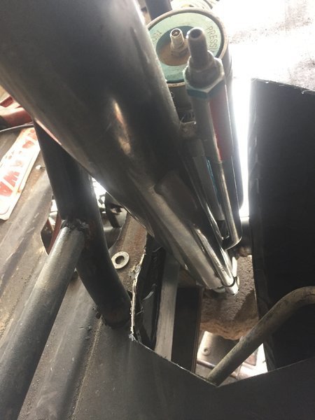

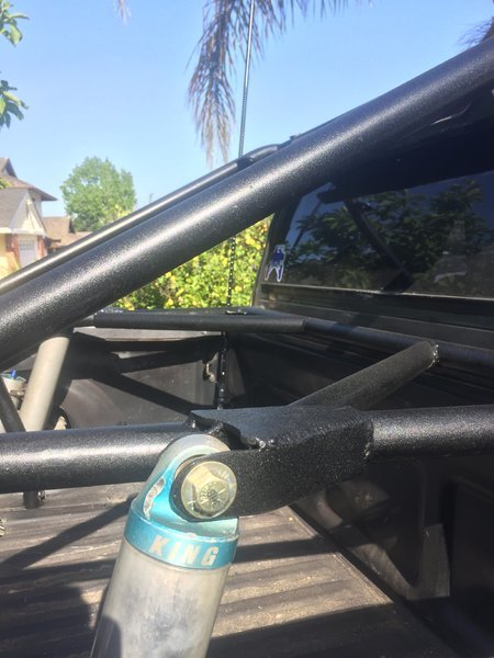

    Got some pictures of my bedcage progress a couple days ago and was told it should be done by Tuesday. The objective was to maintain as much usable space as possible for surfing, biking and camping stuff so far its looking sick!

    It would be worth your time to get 4 tubes bent 90 and splice with a rosette weld to your existing vertical tubes. Someone local can whip up 4 bends for you in 15 minutes.

    I would agree. Are the shocks going outside the frame? Looks like you're gonna have a gnar angle

    Wtf. Why did you put a miter instead of a bend there? Wtf? Wtf? I'm so confused on what part will fail first

    U need friends with tube benders dude

    relax guys its not near being done and this guy kills it at this stuff. your entitled to your own opinion but at the end of that days its not on your truck so stfu

    yes outside the frame. i told him i want the shocks close to 90 so the angle shouldnt be that crazy

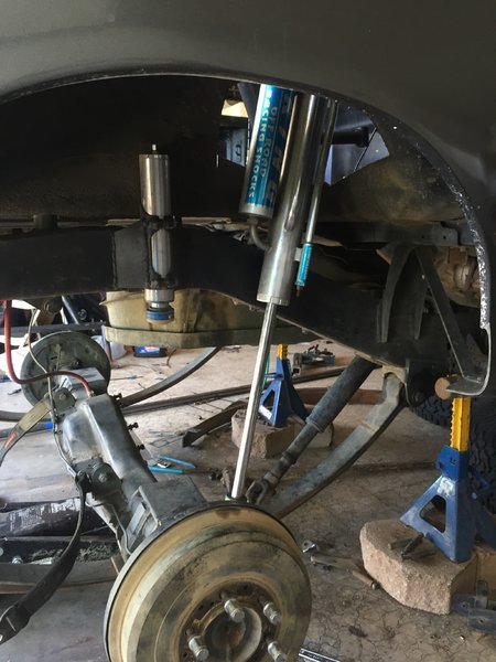

    With the looks of the cage it's gonna be. You have a tundra axle right?
    Your cage looks further forward than mine, and look at my angle. That's with 3" tabs too image.jpgimage.jpg

    no i have the TRD axle with the locker. Hes Pretty knowledgeable on this stuff plus he has my shocks to mock up so it better not be a bad angle haha

    You will not fit shocks outside with the stock axle. I promise you.image.jpg
    And that's with a tundra axle....

    Wheel spacers and smooth bodies
