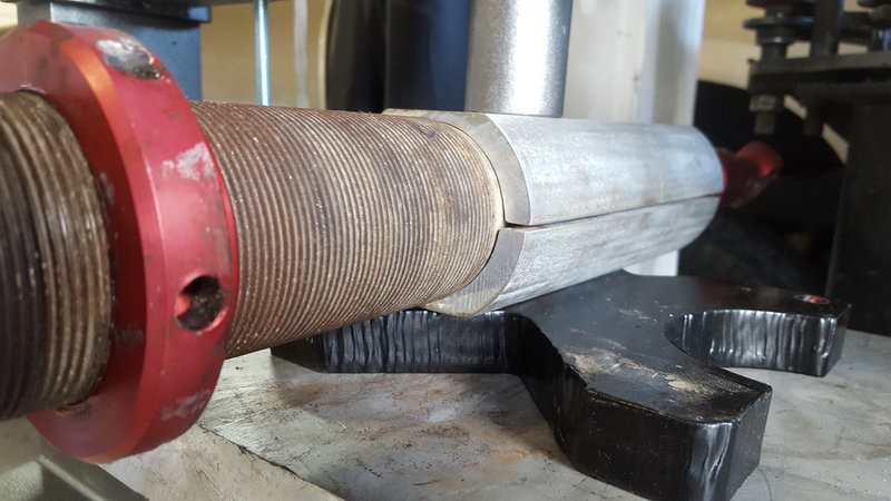

    Just gotta have or make the right parts.
    This was to heat the spring adjuster and get it to move to adjust ride height. Same concept to remove the top cap with my 24" adjustable wrench.

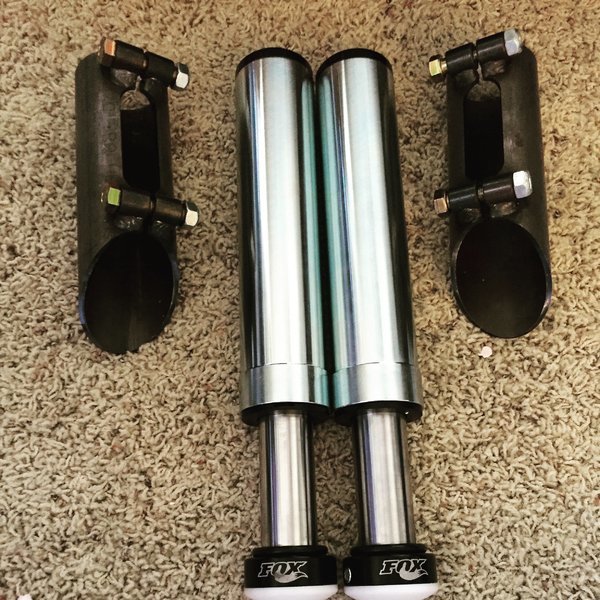

    and now the coating is ruined...

    It's SAW. The coating is already ruined lol
    But really my saws up front suck coating wise. Rust like crazy

    how?
    no different than holding a coated shaft the same way and better than a chain wrench or large pliers.

    Nevermind, looked like the coating at the top was ruined from having to use heat, now I realize they are just old SAWs. Either way, when removing the top cap most of the time you have to heat them up pretty good, which on a nice shinny shock there is a chance of ruining the coating

    im not putting 2k shocks in a vice or heating them up lol

    Thats a press works better than a vice.
    A small propane torch will not hurt a thing other than to get rusted or corroded parts to move. Better then dropping 1k on new bodies when it's not needed.

    Soft jaws are your friend
