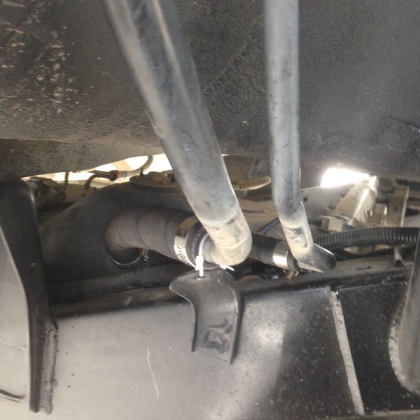

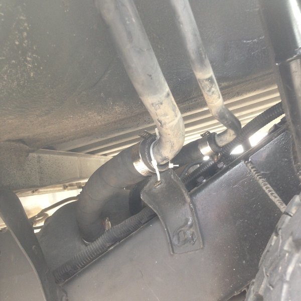

    Im Not sure what the 2015s look like excatly but i just did my 2001 by measuring the tube that goes in the actual gas rubber tubing and they fit nicely heres a pic. i think this is what your talking about. mine were 1" and 1/4" for reference

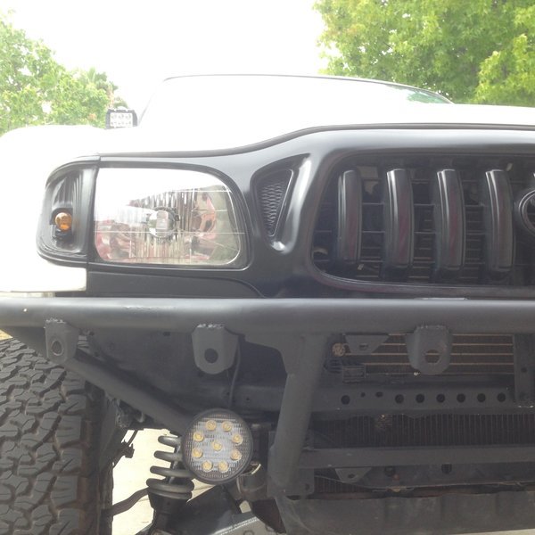

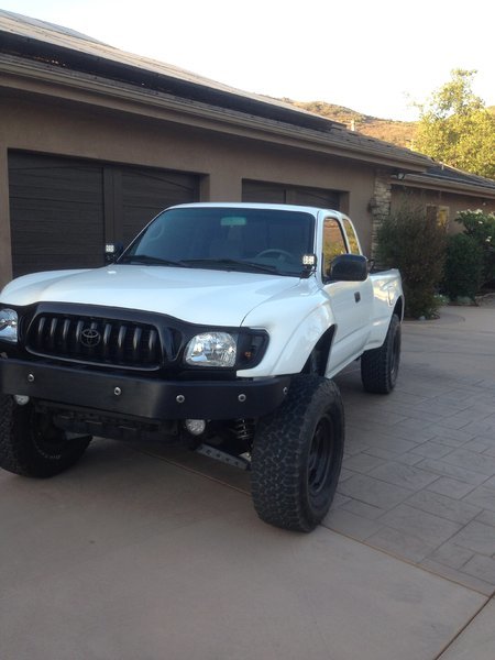

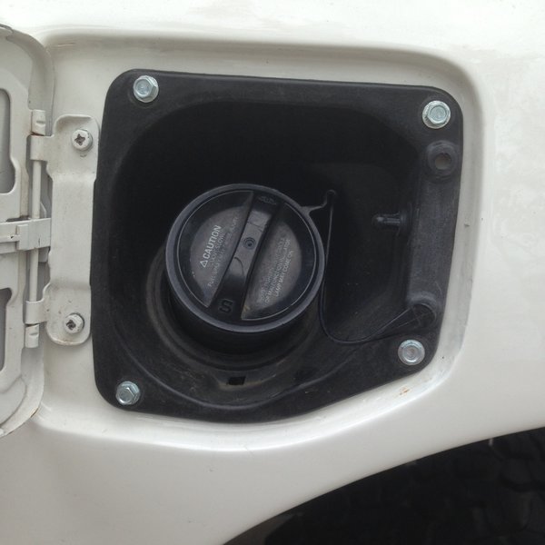

    let me know who does yours cause i wanted to go for the same thing so i welded on tabs and bought ABS Plastic cut it all out and it was pretty sick but as soon as it got hot out the plastic expanded and warped so it looked like shit up close. I was thinking of trying some sort of black sheet metal i think it would look bad ass!
    ps i know my welds are shit haah i just got a welder and didnt know wtf i was doing
