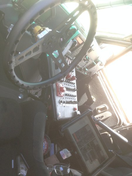

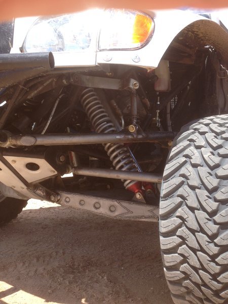

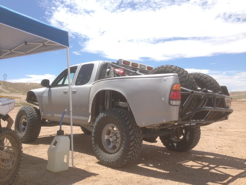

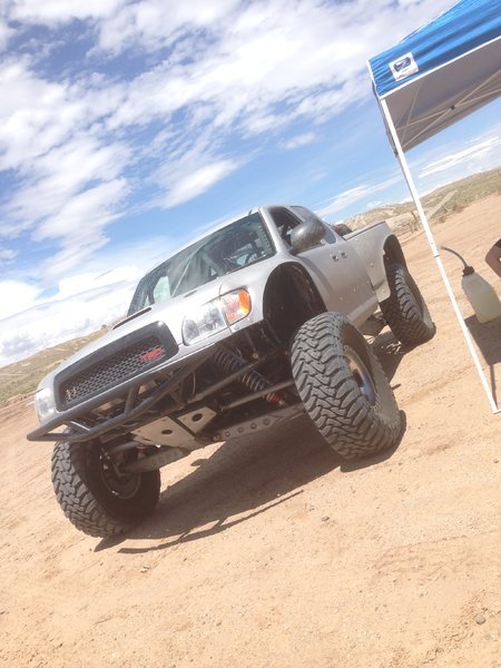

    Out testing my buddy's Scott's truck. J arm front, 5.7 tundra, all fabbed in his garage. Came out bitchin been building it for about 7 years now

    was lookin at that rig on IG its such a bad ass build!

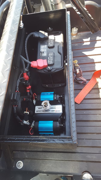

    Is 2g wire enough for battery relocation?

    Probably, I used O gauge and it's overkill

    Yes. It's what I use.
    Just make sure to run the battery ground down to the frame and not the body.

    Did you route the cable on the gas tank side or passenger side??

    I never route anything by the exhaust.

    What size breaker did you use? I just did t wanna have to run my winch neg and pos all the way to the bed lol

    Then run a zero gauge positive from the bed to a distribution block up front.
    Don't remember the breaker size off hand. I just did the math of what I needed and rounded up.

    I ran a breaker at the battery in the bed for the max current the cable can handle. I run a 200A for my 0. At my distribution all the other stuff has its own fuse as if I have a battery under the hood again.

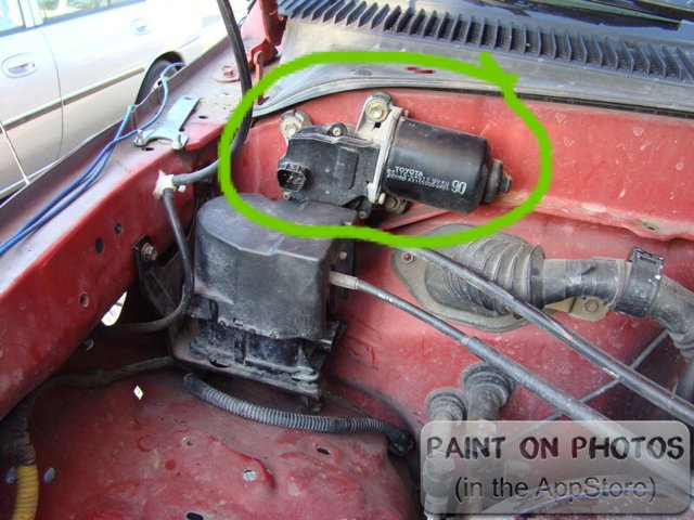

    Do you know what this is ? I don't have the cruise control box

    Wiper motor
    Edit: that looks like a cruise control box beneath it.

    Tell him to come race it the weekend of the 20th out in Fabens, TX!

    Any photo's of the 5.7 mounted in there? Always been very curious how well it would fit.

    still out testing and tuning the shocks. still haven't done a hard test on it
