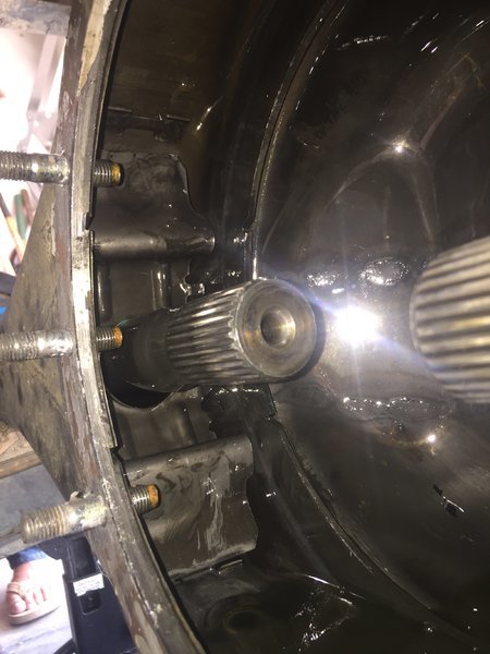

    anyone here remove the oil baffle/deflectors in the rear axles ??

    What are you trying to achieve? If this is to deflect from your vent, just move your vent away from the 3rd member

    Only reason is because my damn axle shafts will not stop rubbing them ever since I put the arb in. It's been to the shop once and I've pulled the diff 3 times. On the 3rd time I bought brand new deflectors and tac welded them in. The sound isn't that Loud but it's annoying and I'm afraid of metal getting in the oil

    Can you just trim the deflectors a little?

    Don't think so
