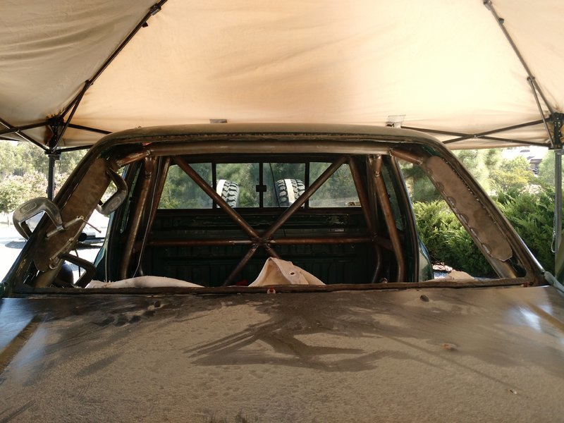

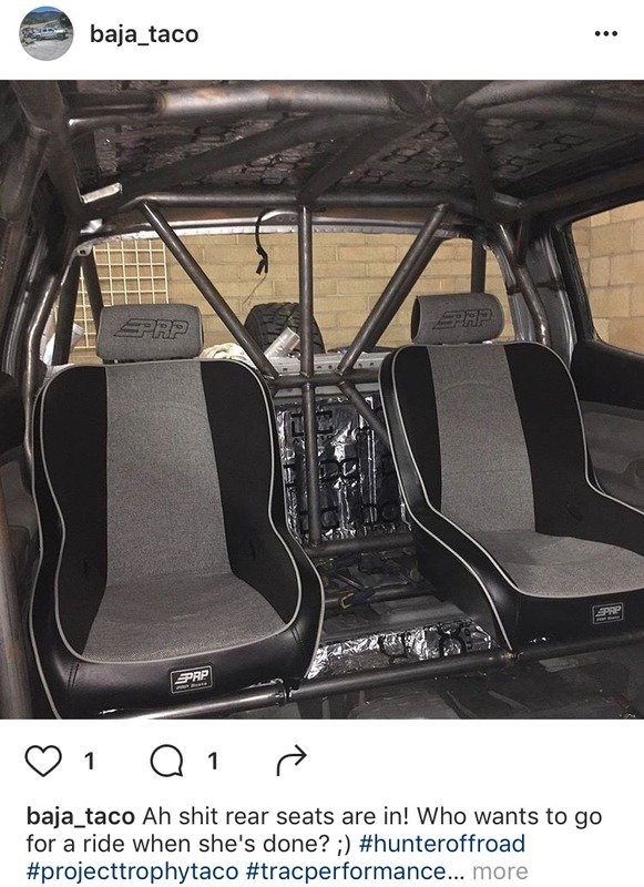

    Please tell me I'm wrong but this rear web among other things in this cage is absolute crap.....

    I've seen other pics of that truck during construction, they cut the whole roof off to do the cage too !? you can see the cut lines on the C pillars.

    The tubes should come together at a point like my C pillar. I can't really see the roof line too well from this angle.

    Yea I looked at othe pictures of the truck and wow, for cutting the roof off there is no excuse for not having a pretty much perfect triangulated cage, the roof has dead tubes all over too, real bummer to see this kind of stuff come from a shop, bet the welds are nice but the rest is junk

    Sounds like a ZZR cage right there. Last time I saw Zip he was building a lower, the inside of his lowers had almost no structural integrity, just random bits of metal he welded at whatever angle would fit for that piece of metal. His cages looked roughly the same.
