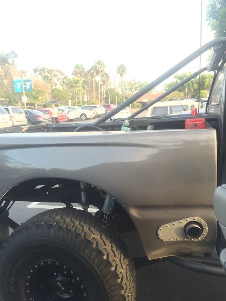

    extra cab i would buy those though i they fit

    2008 dcsb trd offroad 4wd
    No rub here on 35s
    Actually it does barely touch the top

    those arent trimmed at all?!

    Only a little at the corners. Zero trimming up top.

    oh chill! one less thing to worry about. need to start saving for that stuff :censored:

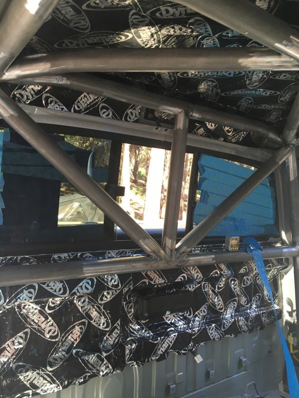

    My doors are the only stock things left besides the headlights
    Granted this is just the first pass so it's not super weld porny but is this what tube junctions are kinda supposed to look like? Derp

    Don't mean to beat a dead horse but what is you guys' take on welding junctions? Weld each tube individually or as an assembly?

    i start middle tube connection then switch off opposite sides on the outers. good heat dispersion and penetration is what matters imo

    I've done it with welding the center tube first then the other ones, the pic I posted I did the left and right tubes all the way first then the center one... That way I think is easier to do

    Rear web Done! Now for the b pillar stuff
