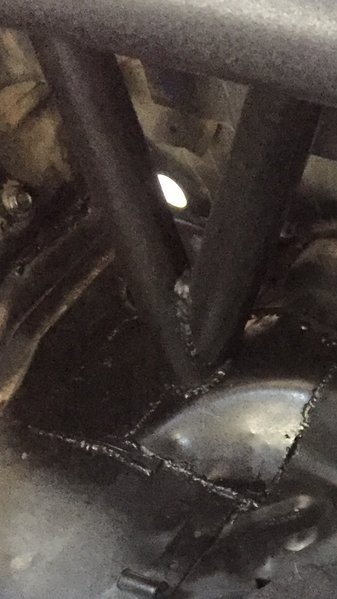

    That's why I gave up ):

    I hated that part hahaha

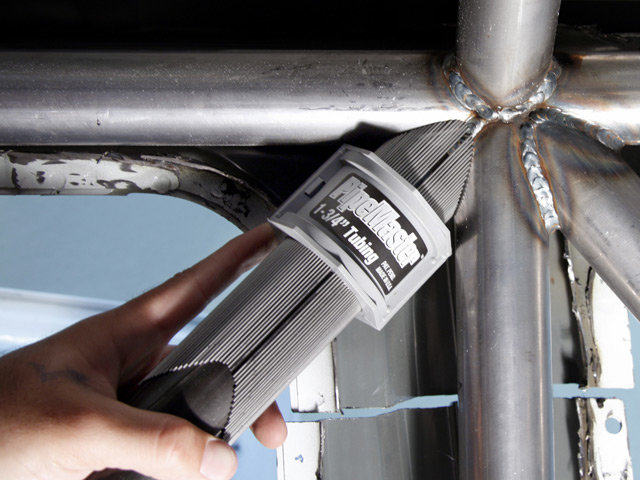

    image.jpg These things help with weird notches

    That thing is rad! I want one, that's better than my masking tape mock up tubes and taking angles off the tape

    They work pretty good, the needles flex a little but it gets you close

    I was almost thinking of doing that but too lazy to buy one of those. Paper towel roll is super close to 1.75" I used scissors to find my notch. Cut the roll open and draw over your tube.

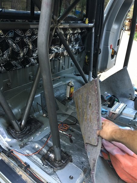

    image.jpg That's what I used. Trigger welded then used seal spray.

    yea I used 18 gauge and did exactly that, just triggered the shit out of it with the MIG, helps with the whole not blowing more holes into the floor thing lol

    Had to have someone with water on the outside....
    Back of the cab kept catching on fire. Big flames lol. There like rubber shit back there

    yea I caught the tar shit on fire a couple times.... have a bottle of water handy and cover your gas tank with a welding blanket....I soaked the tank with the hose too cause yea....sketchy

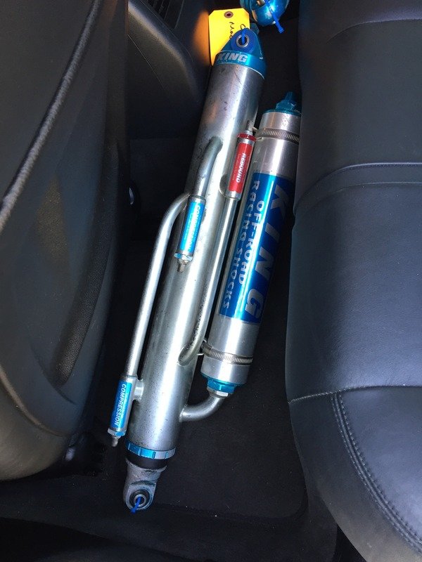

    I got some 3.0x16's today.
    0D1F8427-BF17-49FD-8470-4FC96C729418_zps_3721c8d3fa2cf865b6e9908a8f22b15673aa810e.jpg

    dang nice how much were those?

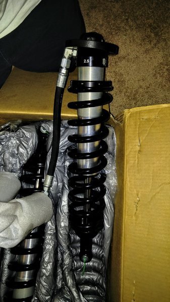

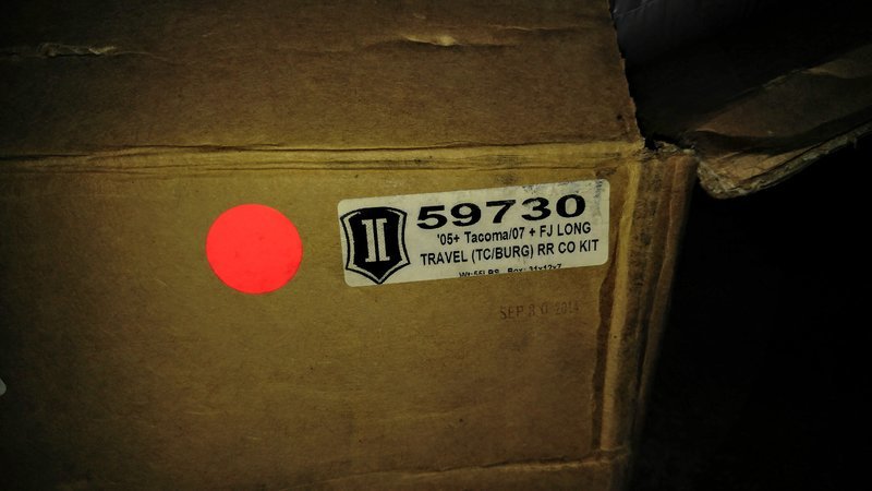

    Since this is the BS thread, I figured it'd be safe here. If you know anyone starting a prerunner LT build let me know. I made a an un-educated buying decision on an ICON CO kit flame on.... thx

    Icon co kit ? Mid travel?

    mid or long

    you bought their long travel specific coilovers, will fit any +2 or +3.5 long travel kit. $1799.95 retail cost :thumbsup:
