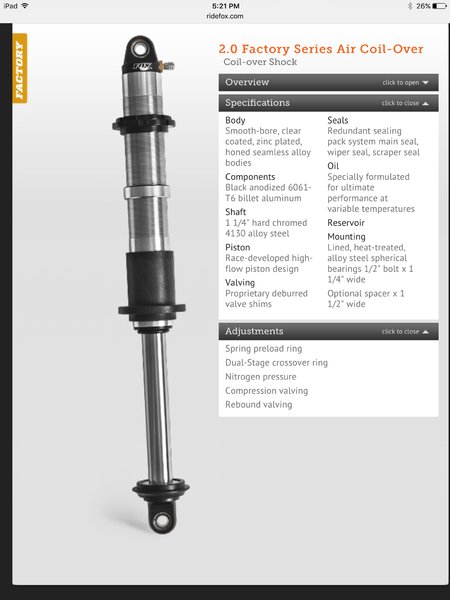

    I have no idea your background on shocks, but I do like to hear different theories. I am collecting parts for my current build. DCSB V6 4wd Solo XLT front, linked rear will retain the "full" bed. Goal is to chase/ prerun in Mexico I'd like to make a removable rack for a RTT over the bed. Naturally going from a fun day in the dirt to a loaded down rtt+gear baja chase trip will change the ride height significantly.
    Could I run a bypass+air bag similar to a Funco sand car on the rear to easily adjust ride height each trip as needed? How do bags do with wear/longevity? Do they make a bag that could cycle that much travel and not get in the way?... airbags give a very nice ride over chatter as well which is a nice plus.
    The bypass/airbag would be nicer for packaging, but this has been run before as well: (company doesnt make this anymore but it's nice for discussion). This is nice because it would allow of ride height adjustment, and if you lost a bag you could swap a generic tender spring to get you through your trip.
    The rear is still in the works so this is all just discussion, but I'd love to hear any thoughts on it, good, bad, or otherwise.

    You should always revalve the coilovers when you add bypasses.
    FYI adding the second shock is to share the heat load over the two shocks, it won't magically make your truck ride awesome without some work to tune the shocks to your driving style.
    If your current coilover is too stiff you might need to lighten the comp valving in addition to the rebound, this is without the bypasses added to the equation.
    I worked on a Jeep that had a similar air ride setup, IMO Junk.
    You're trying to make 1 truck do to many things. You could run a higher than normal lower spring rate and set the spring stop to engage early so when loaded it it rides on the higher rate spring.
    IMO Set it up with all or most of your gear and get your spring rates and valving set to that. The RTT isn't that much weight but can make your truck ride very different with it on.
    You could run a Air shock and bypass and change your ride height with nitrogen. Or even something like this for a coil carrier.
    http://www.ridefox.com/product.php?m=offroad&t=shocks&p=3359
    But these are just some ideas, you should consult the shop doing the work and the shock manufacturer you choose to get it properly dialed in to your needs.

    Wow, I called Fox the minute I saw this because I have very similar needs. I 3 linked the ass end last year and it has 12" King's with 400 over 450's which according to king is the correct combo for my set up / weight but the load capacity is shit. Just opening my rear swing out gate dips the ass end a couple of inches and when I load up the truck for trips it's riding a couple inches low in the back too. I could just keep upping my spring rate to get load capacity but then daily driving it would be stiff.
    When I was building the truck I inquired about this type of set up but was told by someone else that they were only available in 2.0's and intended for much lighter vehicles like buggies... guy at Fox just said nope these are designed for exactly what you are asking for - load capacity. So it is in fact a true coil over / air shock combo. The 2.0 provides up to 500 lbs of additional load capacity per corner and the 2.5's 1,000lbs per corner. It seems the only " con " is that after running a dirt road for an hour the heat in the CO would increase the pressure and lift the truck a bit. He said they are not anywhere near as temperamental as an ORI because it still uses springs. Seems like you would definitely want your own nitrogen fill set up at home to dial it in and play with it but overall these seem like a reasonable solution for load capacity / ride height adjustment ...what am I missing ?

    No, the actual air coil over, I don't see that in a 2.5. I understand it is completely different than a conventional CO but a 2.0 just seems too small ?

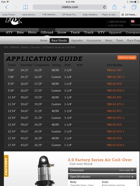

    I was referring to the fox link he posted, they are an air assisted 2.0 CO with a 1.25" shaft, dual rates etc available from 7" to 17" stroke.

    Yeah I'm super curious about the quality of these. You can get them custom valved and do dual rates just like a regular CO. Fox said daily driving or environment will not heat them up enough to make a difference I.E.: your truck sitting higher when they warm up. They said driving a rough dirt road for an hour might cause +50psi ( they hold up to 500 PSI ) I am going to price them out, for a linked expo rig these could balance the loaded weight problems far easier than having to pull my wheels, droop the axle, contort myself inside the wheel well and add a couple inches of pre load a 1/4 collar turn at a time, put wheels back on, load truck, unload truck at camp site and drive around stank bug during trip and reverse the whole process when you get home... these would be load truck - add nitrogen until level - done.
