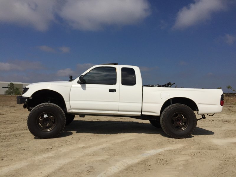

    if you can find someone who owns a nice paint gun and do your research you can paint it yourself. painted my front and rear glass in my backyard and i think it turned out almost perfect. that does limit you to painting your car its OG color cause you can remove the fiberglass

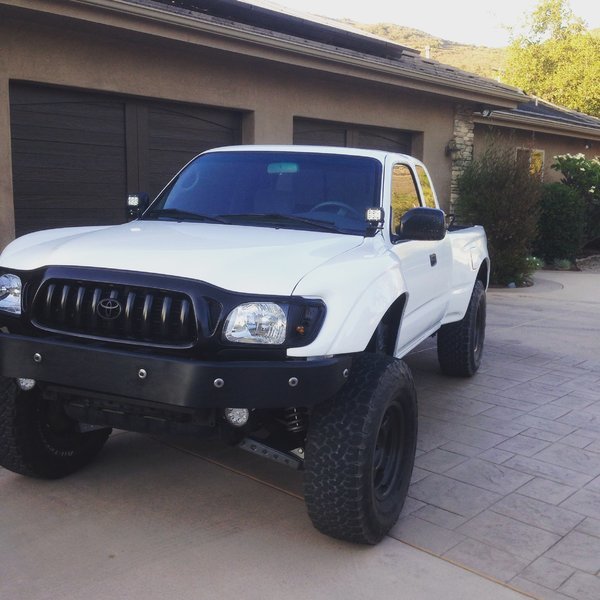

    I did mine myself, only took a couple hours with a cheap HF spray gun and some color matched paint from a place in Kearny Mesa. Didn't even prime the glass, just a fine sanding and some windex. I left it without clear (nice matte look) and its held up really well for a couple year now! Now I gotta do the fronts to match (was rattle canned like 6 years ago)

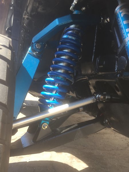

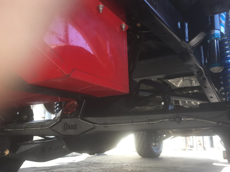

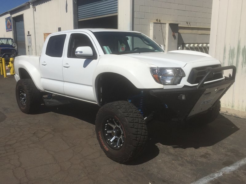

    The latest build is this 2015 4x4 double cab. Linked with Currie axle, stock bed, and fuel cell. Up front is our new 4x4 kit using Dana 44 hubs and custom axles. Utilizes the stock inner cv for easy installation. Full heim steering and fabricated spindle with unlocking hubs.

    @TRACperformance Looks great!!
