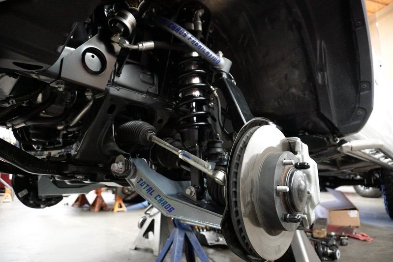

    I just did the stock width TC Race series lowers on my 2017 build but without the secondary shock mount. To clear the secondary mount you need to run a 1.25" wheel spacer, and at that point you might as well run their +2 kit and going off my past arguments might as well go all the way to a full 3.5" over kit.
    First time I have posted a picture of the new suspension.
