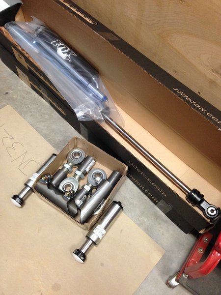

    image.jpg image.jpg Threepointwhoes and a couple sticks.

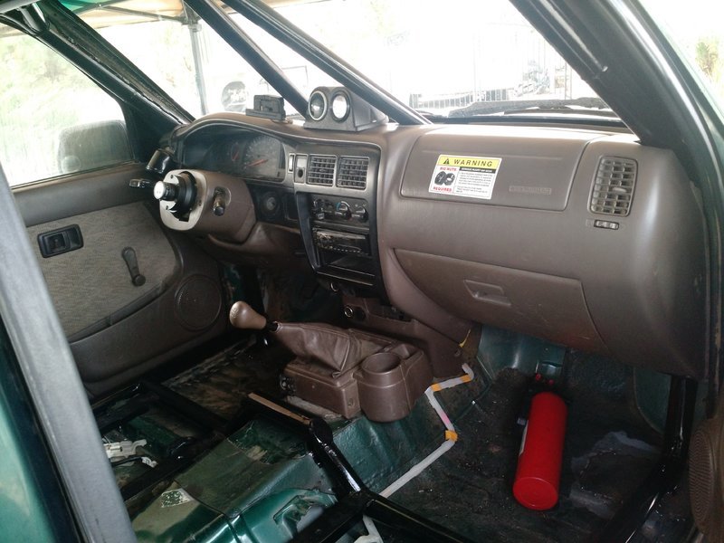

    Where did you tie your V windshield brace into? And what size tubing, I've got my whole interior torn apart working on the cage, I was thinking into the stock cross brace under the dash, or no? Thanks.

    1.75" main tube, v bar 1.5" you can see I went between the 2 vents if you still want defrost. I welded the stock brace to the cage.IMG_20160905_163528697_HDR.jpg IMG_20161014_161844177.jpg

    Ah I see, looks great, I have like 60 ft of .120, 1 1/2 and was just curious if that'd be big enough for the full cage but I guess I'll need some 1 3/4"
