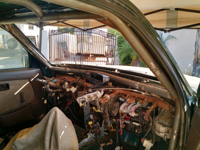

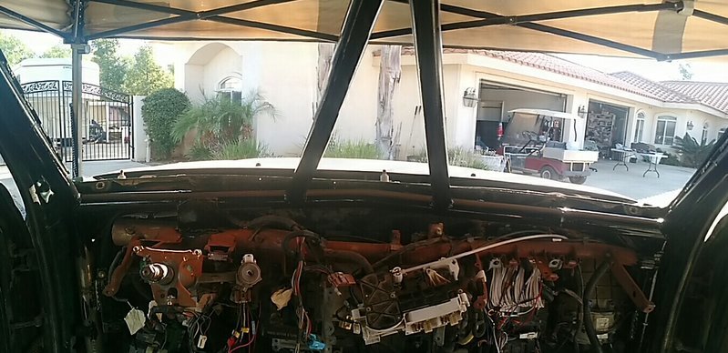

    Are your a pillar bars spliced together?
  9. Nov 3, 2016 at 5:03 PM
    MadTaco461
    MadTaco461 BRO runner
    Dec 30, 2009
    #28470
    13,426
    CA
    99 turbo 5 lug long travel
    Kinda stock
    Yeah it is a splice with an inner slug with a rosette at each end. Definitely frowned upon in that location on that particular tube. It's not a truck for racing or recommend people doing that technique. Doing it over again, I'd for sure notch it into the dash tube to make that section a lot easier on me than defaulting to a splice.

    Sleeved and rosette/plug welded splices are actually stronger than just a plain piece of tubing. I know it's frowned upon but why? Tubes usually fail at bends anyway

    Score racing specs says it needs to be one piece. They usually have the most strict rules. Other race organization might let my cage pass. I wanted a pretty tight A pillar fit so that is why my splice is there. Also I don't have the talent yet to be a really good tube bender in that section of cage. I'm no expert in the rules of off road racing. It's just a low budget play truck.
