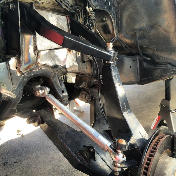

    IMG_1642.jpg Let me know if you guys know anyone looking for a LT kit for a tundra. I have one for sale. It's a Solo motorsports LT race kit. Paid $3000
    Race spindle paid $1500
    Heim steering upgrade paid $900.
    I'm asking $3800 for everything. going to go center mount this winter. The kit has been used but not beaten on, came off of a 2013 tundra with a spring under rear

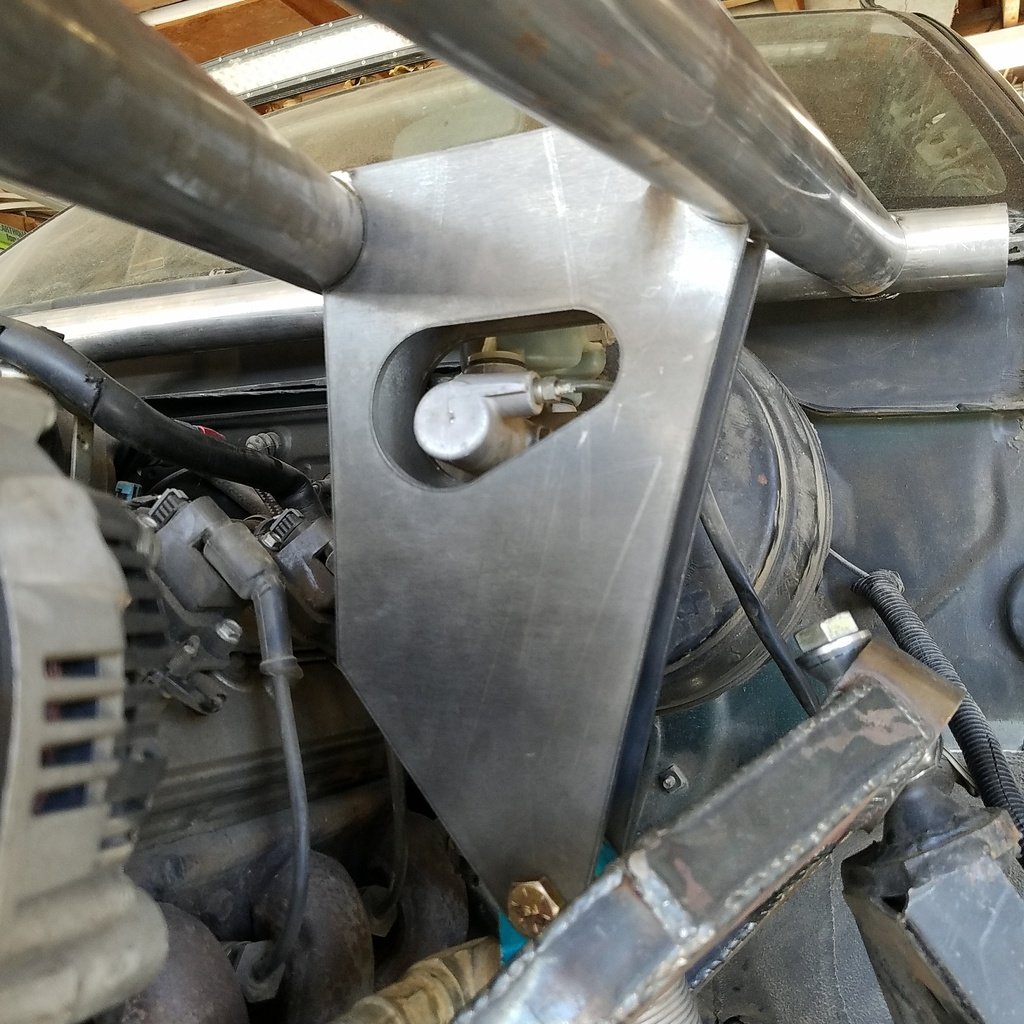

    your welcome and i hate you :thumbsup:

    so if your MC gos bad do you cut it all out?

    Nope. you might have to Flintstone it for a few hundred feet at first, but the master and the booster can be unbolted easily.

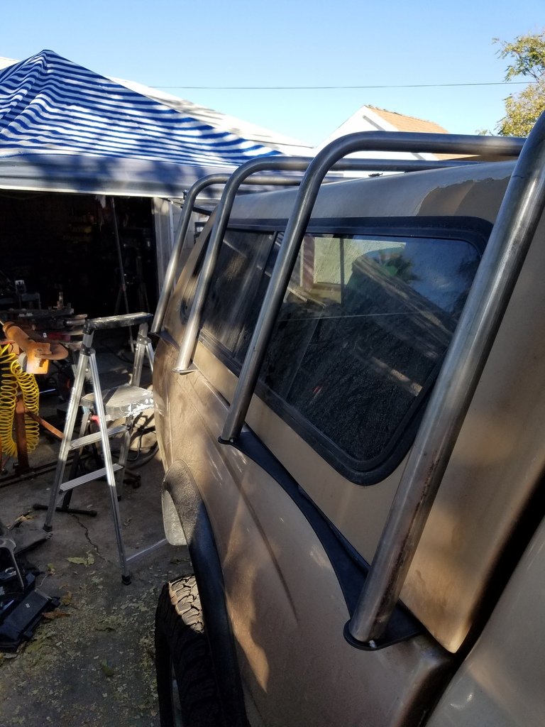

    long traveling bed rack.
