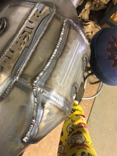

    Root pass done on the armor diaper, let it cool a bit before I start the cap...

    Welding in jammies, awesome! :thumbsup:

    Yea it's freakin cold this mornin in the shop....TIG life!!! Lol

    Is that the Ford 9" full float? It come with everything but the diff, right? (brake mounts, brakes studs etc.) Does it come with everything already welded up, besides the armor obviously?

    Doesn't come with axle shafts either, and the caliper brackets arnt welded on either

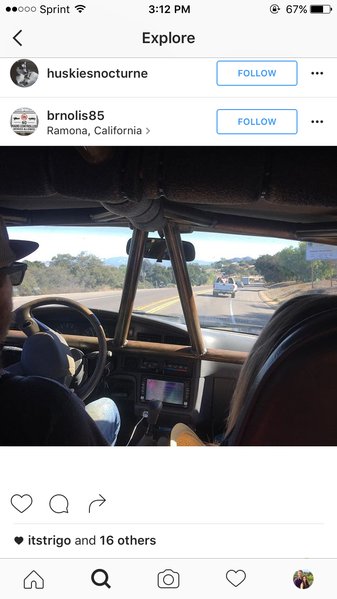

    @Trigo you have explaining to do. i see your like on that
