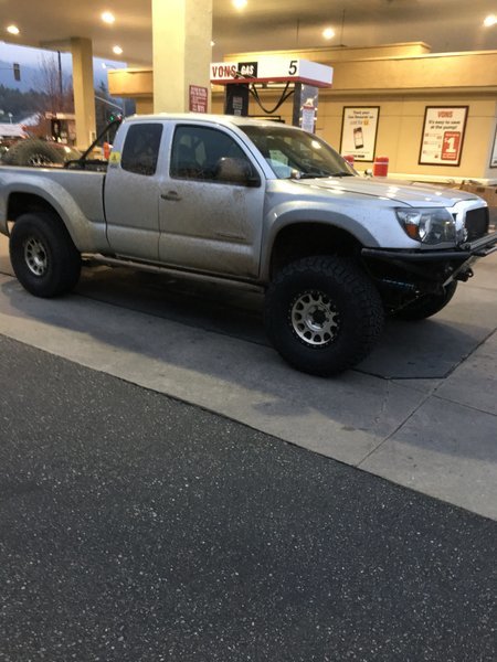

    My doors are the only stock things left besides the headlights
    Finally put 35's on today

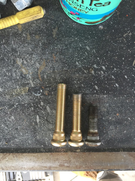

    well i got one rear side arp studs in.. gonna do the other side tomorrow so i dont piss off the neighbors with the constant air compressor and impact lol.. ended up cutting about a 1/4" off each stud so it could fit here are some pix

    Likelyhood of this going down with hand tools in your opinion? Impact hammer seems the way to go but just from a personal experience point of view do you think it would be doable w/o messing something up?

    i wouldnt do it without a impact.. i mean it can prolly be done without one but it would be a pain in the ass.. the impact def made it much easier, and it still took a lil bit for the impact to get it all the way snug

    So the bigger issue is getting the new ones all the way in rather than knocking the old ones out? Interesting I wasn't even thinking about that. Lol
